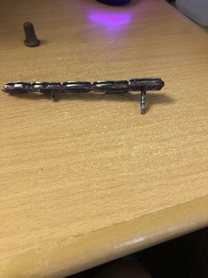

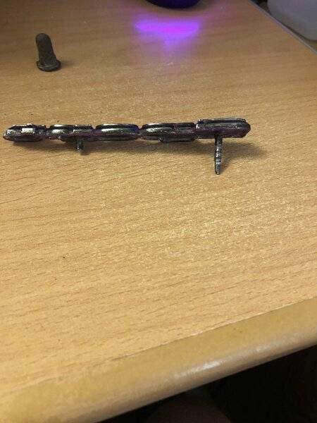

Has anyone successfully repaired a pot metal stud such as on a body tag? I am looking for a robust way to do this and was thinking of doing this way if nobody knows a better way.
Take a thin copper wire and wrap it around the broken pot metal stud to the desired length. Then using a micro torch solder the wire to the stud. If I am careful I should be able to get the stud hot enough to then accept the solder with lots of flux.
What do you guys think?

Got a picture of the back? What kind of emblem?
