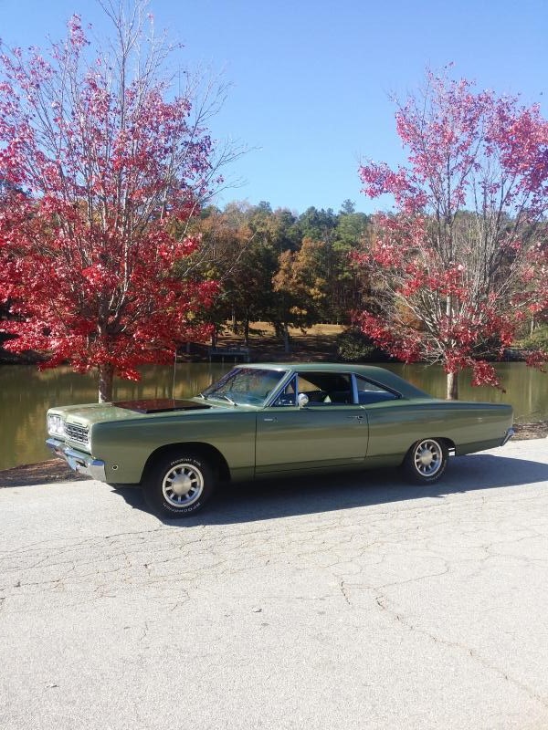

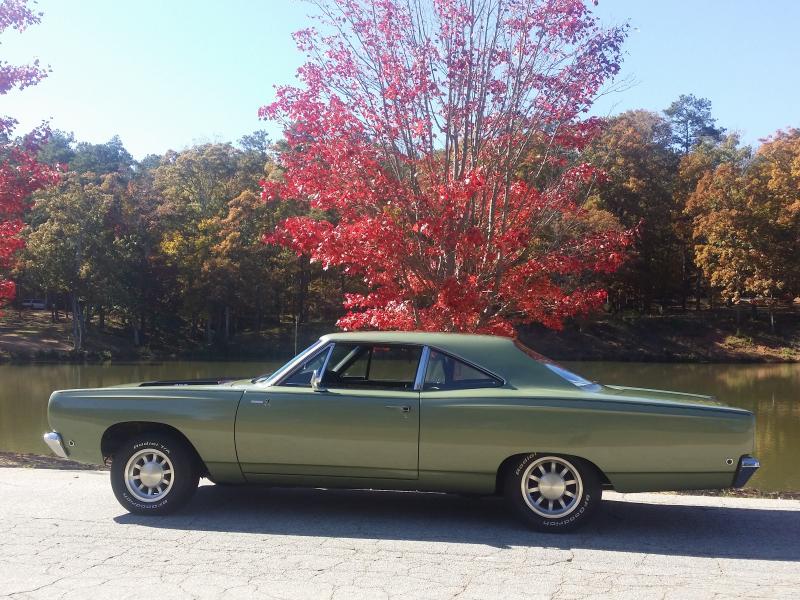

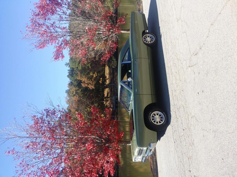

I think that's what I'll end up doing also is pulling the numbers matching motor and get the 400 block. 20141109_134426.jpg
If you want something to go nuts with get a sacrificial motor and keep the numbers motor under the workbench. Then when you simmer down in a few years put the numbers motor back in and cruise.
Good idea because it will be awhile before I settle down haha

Nice Bird BTW!

It may be a numbers matching car, but the hood and rim/tires/ride height don't suggest a "numbers matching" car. I would take care of the those items first if you are going to go that route.
