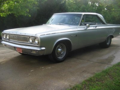

I have a set of 15x4.5" wheels on the front of my '65. They look like they are original wheels. The best part is they are 5 on 4.5" bolt circ. and take
a 9 & 5/8" cap like the pre-'66 wheels do. I bought a bunch of them from a "Studebaker" collector.
Mid 60's Dodge 1/2 ton had 16" wheels with the bumps for a 9&5/8" cap. Because of the larger cap about the same amount of paint is exposed so they don't look out of place.
