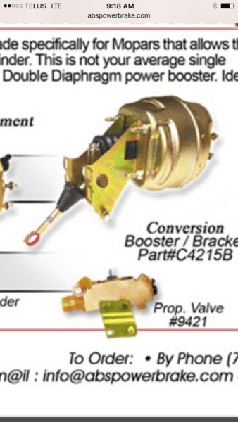

On My 69 Roadrunner The Car Was Originally A Manual Drum Brake Car..
I'm Going With Wilwood 4 Wheel Discs And a 1 1/8 Bore Wilwood Master Cylinder..
I'd Like To Use A Stock Style Power Booster Without The Mounting Brackets That Move The Booster Forward.
Having a Hard Time Finding a Stock Style Power Booster To Go With My Wilwood Master Cylinder..
Is There A Reason Why These Brackets Need To Be Used?
Thanks
That bracket and exterior linkage was used on hemi cars for valve cover clearance. Dr Diff has what you need.
Try the Ram Man, google him, he is full of info, you don't need that bracket setup.
