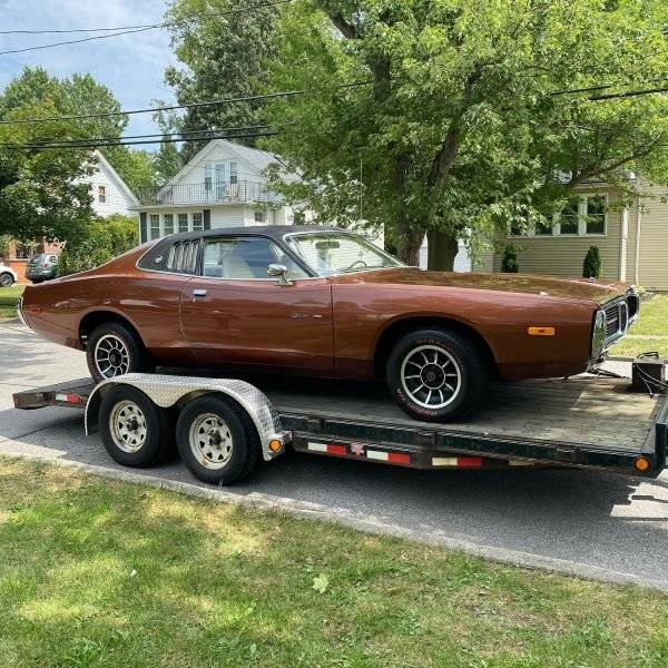

My mom just purchased a 73 Charger, a car she has been after for years. It needs a new master cylinder, and I'd like her to have power brakes. I called SSBC because I've used them in the past and they have the parts but they said their kit is good for up to 1972. They didn't know why. I don't either. Any insight? Or a different company I should use? In terms of parts and repairs I've almost exclusively been around GM stuff for the last 15 years.
There is a non-power aftermarket master cylinder on the car now.
