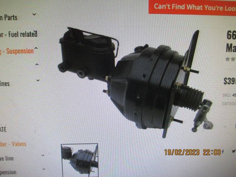

Since your booster is aftermarket if it's this style
I wouldn't expect much.... I've worked on a few cars with those, the first car I put three boosters on & finally bolted on a used original booster that fixed the problem.. Since then I go straight to an OE booster...
Talked to a buddy that owns a local performance shop, his guys had swapped dozens of those under warranty & finally started converting cars to Hydraboost.. Till they got a bunch of bad Hydraboost units & then they were really screwed.... Wound up eating a lot of repairs to keep from getting sued.... There is a reason a lot of shops don't want to get involved with aftermarket parts Hel the OE stuff these days create enough come backs....
When I pump the pedal and hold it and start it there's no drop in the pedal. This is what I bought from Roseville Moparts
I have zero experience with the new Chinese knock offs of the original Bendix Booster.. I know the real ones work good... I don't know if the new Chinese ones act like most Chinese stuff of if they got it right... The fact the pedal doesn't move isn't very promising....
