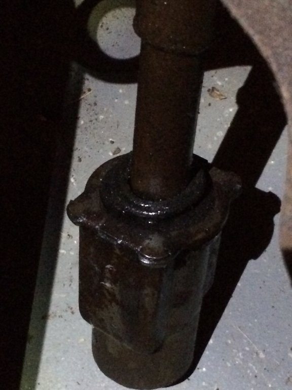

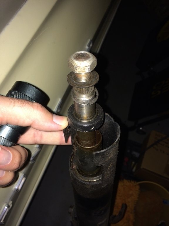

OR.... you can cut down the center of your existing shaft & re-drill some holes, tap & screw in nylon screws to make your own "shear pins". I just did this swap in a '70 and it's totally possible.
Here are pics of the spline and 3" coupling (soaked in oil).
