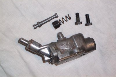

The valve body where the hoses connect can be adjusted. Slightly loosen the 2 bolts that fasten it to the box and then slightly move it forward or back til you find the sweet spot.
Here is a pic of the valve
When you find the sweet spot you'll find the Mopars steering easier than GM. I've owned around 30 GM's.

I've heard those called flow control valves, valve body and spool valves. Anyways, I like to check it out with the front wheels off the ground. If they stay straight with the engine running, it's probably set right. Did the alignment tech give you the settings that he used to align it with? I haven't had much luck with any alignment shops in my area so I learned how to do it myself. Also, the factory alignment specs are not to my liking and always had to fight with the alignment shops to give me what I wanted....which is more camber and caster (with radial tires) and over the years I've experimented with plenty of both. If your caster is set close to 0, then that might be part of the reason why you are having to always correct all the time while going down the road. Also, most Mopar steering systems have had the 'one finger syndrome' which I kinda like anyways but don't like it too much with factory settings. if it were mine, I would try and find a shop that 'speaks' Mopar and talk with them about what you are feeling and ask about dialing in a bit more caster (caster helps with high speed wander) and see what they say and then ask about adjusting the valve. BTW, ask the tech if they know about the alignment adjusters and how they work. They DO NOT go full circle and if they grunt on them to make them go full circle in trying to align it, then you will have damage to the cam slot ears (don't know the correct name for them) but the cam adjusters never are supposed to be turned more than 180 degrees if that much or damage will result in the seats they are in. Also, some reading here should help.... http://www.allpar.com/history/mopar/front-end-alignment.html

Jake it up put jack stand under the lower control arms as far out towards the wheels as possible and set it down with front tires of the ground. Start engine if steering doesn't move the control valve is set correctly and you have a caster camber toe problem. If steering moves on its own loosen control valve 2 bolts just enough so valve will move when struck from ends with soft blow hammer until steering stops drifting on it own tighten bolts and you are done. Simple process. Camber left +1/2° right +1/4° Caster power steering +1/4° to +1-1/4° Ride height 1/8" side to side difference max. Toe in 1/8". If you do a lot of 4 lane highway driving set camber same on both sides. This should make your 70 RR go straight down the road.
