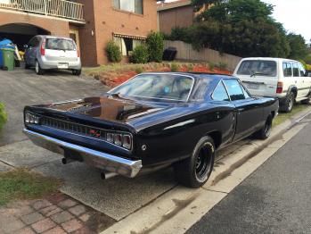

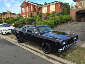

Btw I pulled the car out for a clean, here's a pic or two :)
