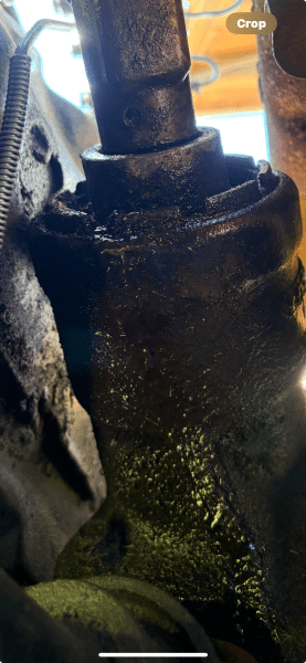

Having the same issue with my 67 Charger. I thought it was the pitman arm seal, but it’s a little higher than that. Can that seal be changed on the car
Having the same issue with my 67 Charger. I thought it was the pitman arm seal, but it’s a little higher than that. Can that seal be changed on the car View attachment 1919684
Is the roll pin in that coupler? Something does not look right. Looks like the coupler is right up against the gear box seal area.
I can feel it on the other end. Any possibility it was installed wrong by someone?
