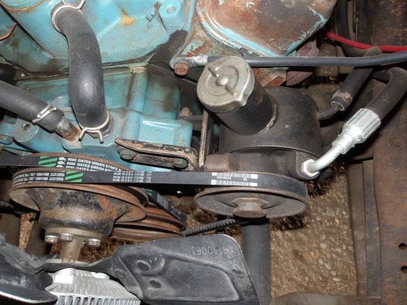

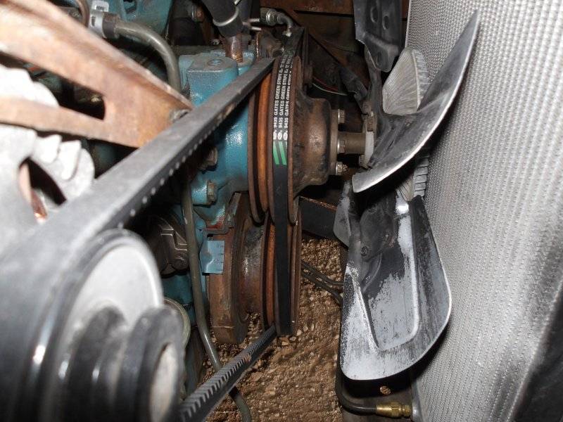

I converted my 65 D100 to P/S, I used a federal pump. This is what it looks like on the 318 poly. It already had a dual groove pulley for the alternator so the alternator became a single groove unit.

Thanks for the photos — I can see where the bracket attaches to the water pump, does the pump attach to the block somewhere?
It just bolts up to the water pump. The pump came with a bunch of extra stuff in a parts car 20 years ago so I don't know what it is originally for.
