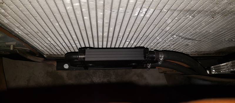

I used this one: https://www.summitracing.com/parts/der-13212
Installed in front of the radiator next to trans cooler at right.
I had an issue with a power steering pump not long after I put the Borgeson unit in a while back, had to replace the pump and also decided to put the cooler in to preempt any possible issues.
I was driving for an extended period at higher speed and the fluid foamed up out of the cap. Trying to figure out what the problem was at the time, possible overheating maybe..?
So far so good with no issues at all.
Fabbed up a bracket and bolted it down for both coolers.
Some guys don't like to put holes where there were none before, I don't really mind as long as it's functional and as you said, clean.

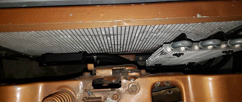

i did same thing as Larrry B. looks like same cooler also although i used some of those push-style zip tie things to secure to my ac condensor when the radiator was out
