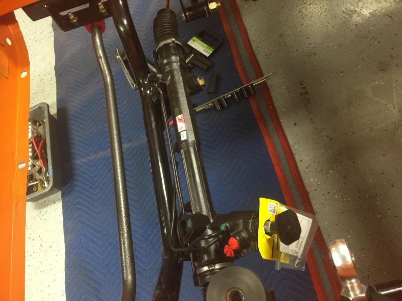

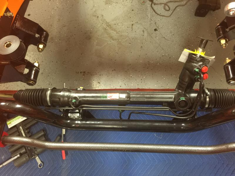

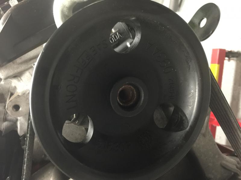

So im at the point where i need start thinking about my Power Steering situation.
My progress so far http://www.forbbodiesonly.com/moparforum/showthread.php?108958-69-Roadrunner-6-1-Hemi-Swap
Im using a power rack and point that came from CF. (Ford maybe)

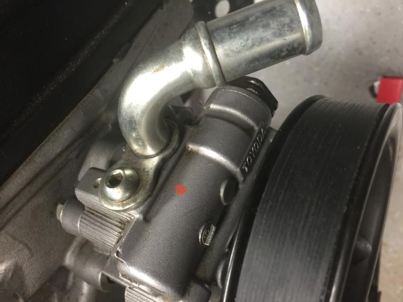

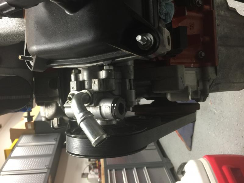

I currently have the stock power steering pump on the motor (6.1L GEN III Hemi 2007 Charger SRT8). I think its stamped "Toyoda"
My question is about the pressure of the stock pump.... will it be to high?
Is there a regulator or device i can use to lower pressure if need be?
Do i need a new pump?

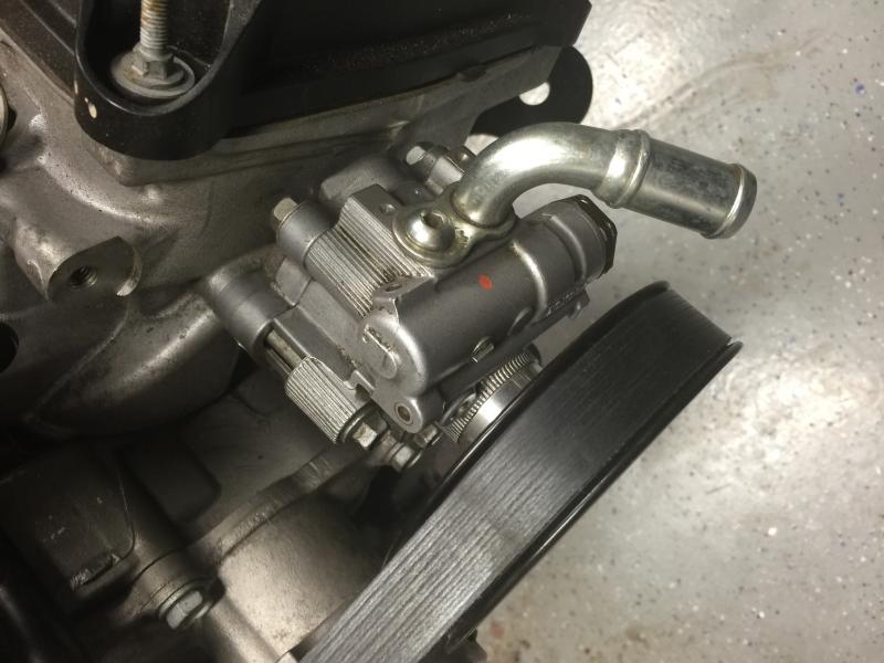

The stock pump on the 5.7, 6.1, 6.4 will be just fine for the rack. There is no need to reduce the pressure. There is a pressure reducer made if you really want to go that route, SpeedWay motors has them as do other places.....Summit, Jegs.
Thank you for the input. Thats PERFECT!

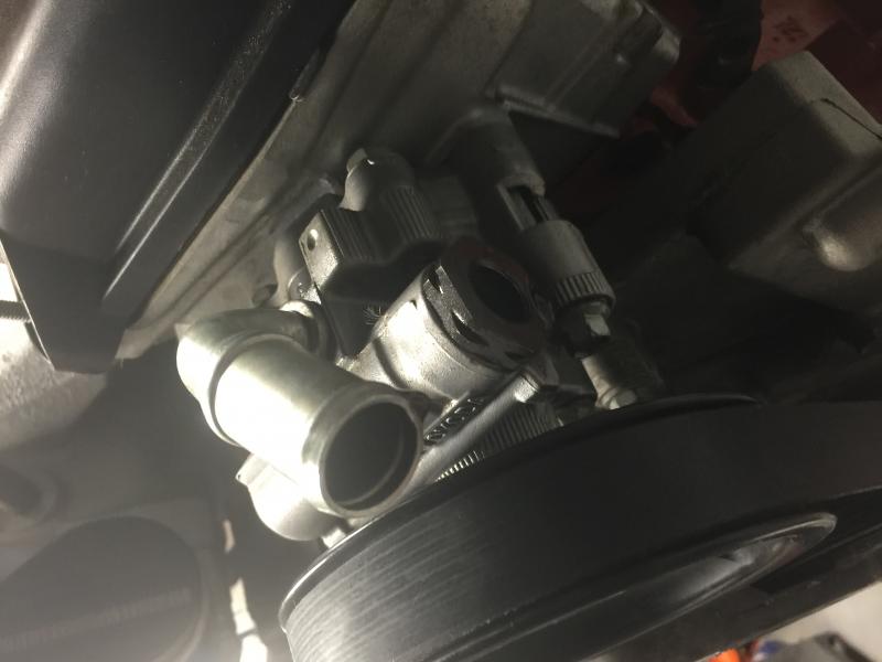

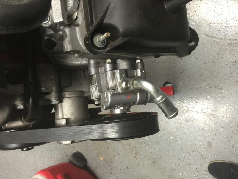

Do you now what would be the fitting size for the high pressure side on the pump.
And... how do i fit it? Do i need a remote reservoir?
I don't know what the size fittings are, and a remote reservoir can be used without issue.
