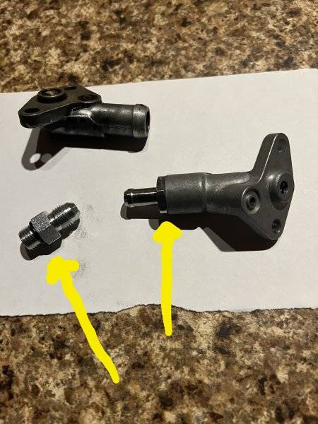

i removed the part in the upper left with the one in the lower right will there be any return line issues ? it’s on the power steering box p.m me with your thoughts
I am not sure why the 1966 and older has that large return hose, and then it was gone in 1967. I don't know if there were any internal changes to go along with it.
Does it look like the o-ring will have a place to sit against and seal up on your steering box?
it came with a o-ring but my original had a brass washer and i am planning on using a brass washer ? even NAPA said don’t use the rubber washer
I would use a copper gasket ( brass washer).
There are 2 rubber o-rings on there. And rubber was factory. "rot" not in out lifetime. What does "even NAPA" Mean? Like they are some sort of automotive knowledge source?
so same question, is there a place for the copper washer to sit and seal this different piece to the box?
I believe he's talking about the an adapter fitting
There are 2 rubber o-rings on there. And rubber was factory. Rubber will rot, not in our lifetime. What does "even NAPA" Mean? Like they are some sort of automotive knowledge source?
i am referring to the small part in the lower left, that has a rubber o-ring that i am replacing with a copper washer, the kit came with both rubber o-rings for the big piece
