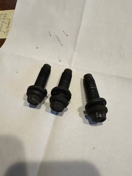

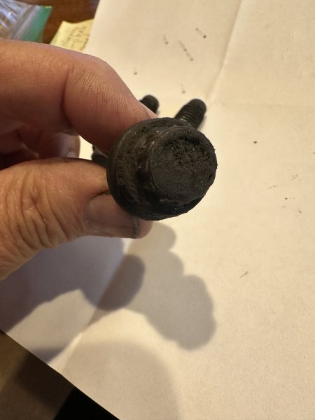

Where can I find the three replacement bolts for a 1968 Coronet power steering pump? They've got a bit of a star top to them. The length of the shaft is 1 3/4" and the entire bolt is 2 1/8".
Is there something special about these bolts or can I simply replace them with a regular hex bolt?
Thanks!
I'd put some threadlock on them as well when you finally come to install - they sometimes come loose and the front end feels wooly. You assume it's wear the bushes and balljoints but it's actually the steering box moving slightly when you move the steering wheel.

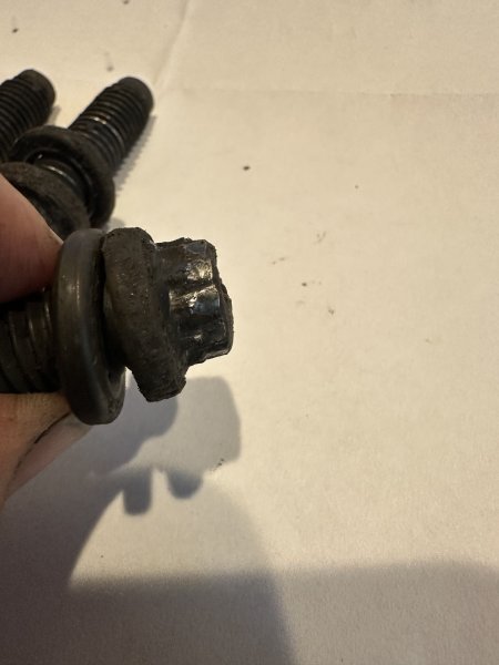

They look like 12 point bolts, with the points rounded off from using an ill-fitting wrench.
