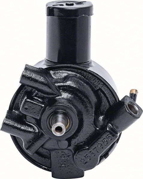

So I am looking at ordering the Firm Feel power steering box for my Charger and thought I'd get the pump as well.
Firm Feel lists three different pumps (Saginaw, Thompson, and Federal), but only shows a picture of one. From a picture search, it looks like they are showing the Saginaw based on the shape of the top of the reservoir.
Do I need to order a specific one to mount properly? If so, how do I tell what I have? Seems like the Saginaw has a unique look, so it should be self explanatory, but how do I tell if I have a Federal or Thompson if it doesn't look like the Saginaw?
This is a federal pump. Not sure about a Thompson
Saginaw for your model....Are you getting the bracket too?

Oh, and I did a little more reading this morning. Sounds like the Thompson is the TRW pump.
