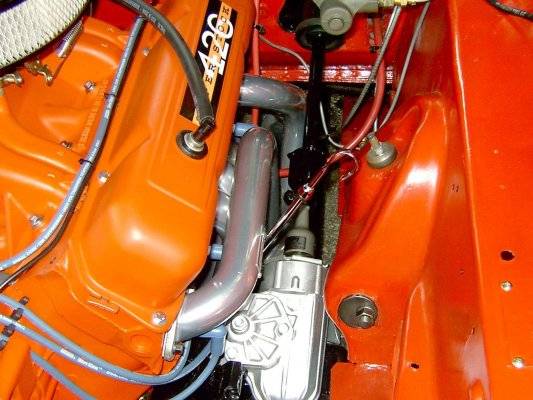

Here is a pic of the adapter I used. I bought it from Mancini. Ron

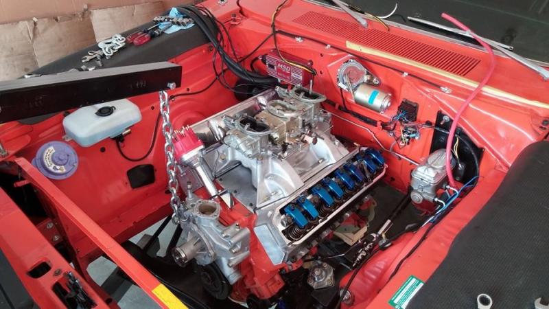

Here is my setup after the buying the Flaming River box and coupler.

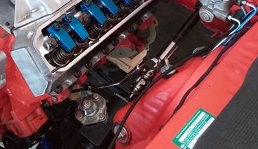

Closer view....View attachment 203065
Very nice and your eng really looks awesome ! I love a clean eng and eng bay. You can be proud of your car and your work ! I take it you have to cut the steering shaft to install that unit ?
Again I must say your eng bay and eng look great ! I like it. Ron
Thanks Ron,
Like you, I also like a clean engine/bay.
I did have to remove the column and cut a sizable chunk out of it to make it fit but I am happy with the results. I have never had to do so much modifying to parts that are supposed to bolt right on! I expected to be cutting the coupler but not the column. At any rate, it wasn't that big a deal, just typical of the hot rod life. If you aren't prepared to modify, you aren't prepared! I hope to have the car on the road next week....
