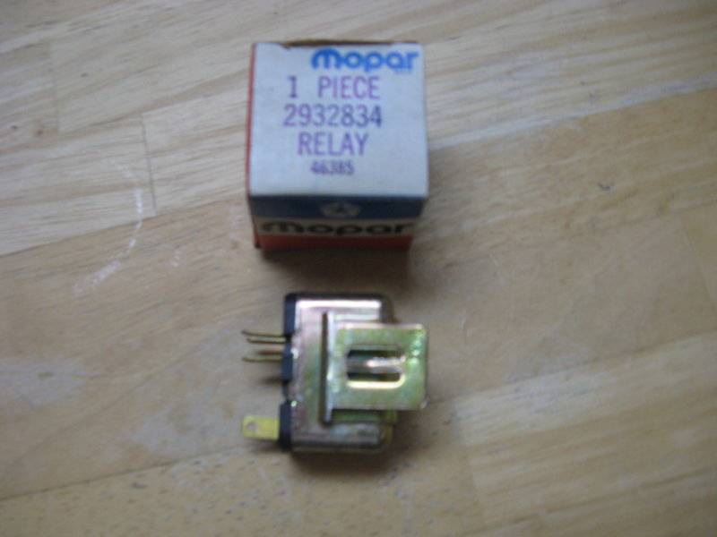

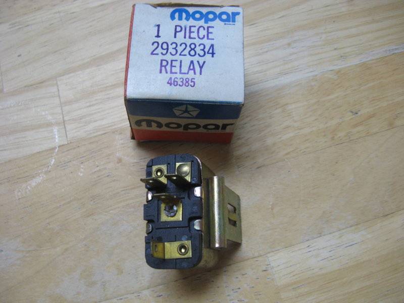

There is a factory relay. I have had a few NOS ones. Here is a pic and some info on models that had them...
https://www.moparmall.com/MoPar-2932834-Electric-Window-Lift-p/823-043.htm
View attachment 738603 View attachment 738604
You sir are 100% correct! I was thinking about people adding individual window relays in addition to the stock safety relay https://board.moparts.org/ubbthreads/ubbthreads.php/topics/142362/1.html
