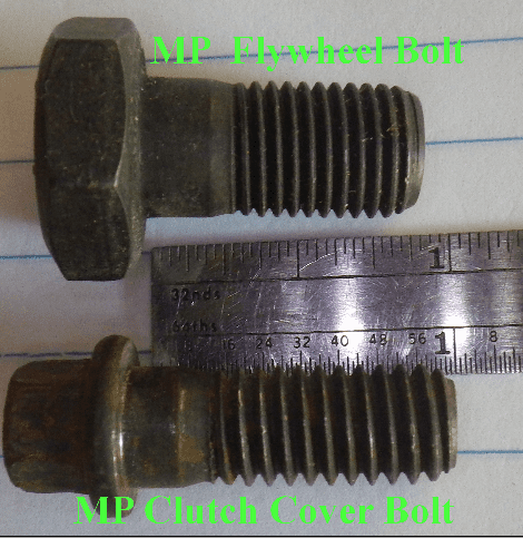

What size are the pressure plate bolts? 11” 440.
ARP part #?
5/16"x18. ARP 3/4" long: 12pt 641-0750, 6pt 651-0750
Bad part is that you need 6 IIRC, so you will need 2 packs. You might contact them directly, and purchase 6 individual bolts. Call 800-826-3045, and ask for the tech department.
FWIW, My MP bolts are Gr 5, 3/8"-16 X 1" with 1/4" shank.
