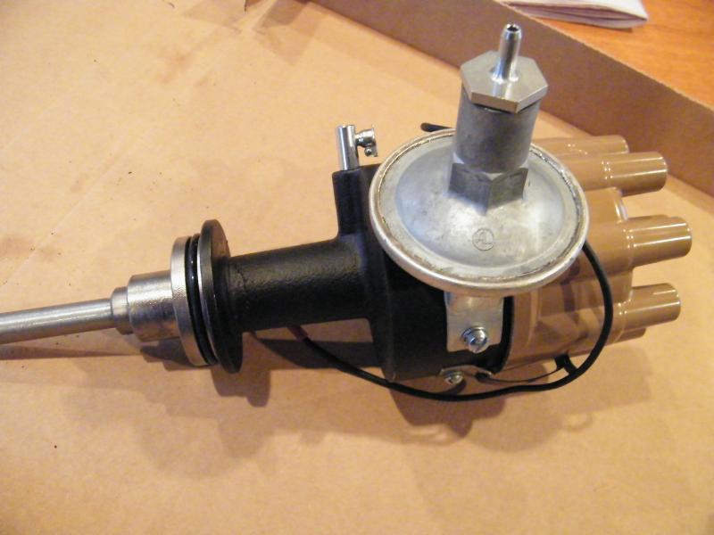

I just sent the distributor to Crossram Connection. I'll post some pictures when it comes back.

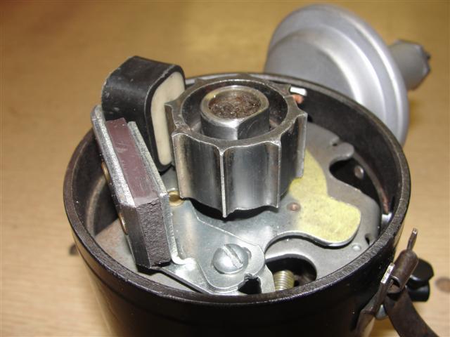

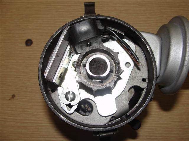

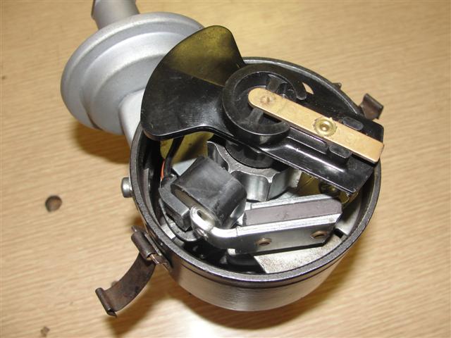

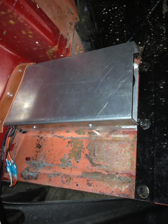

I did this OEM electronic conversion for my 66 HEMI Charger. It fires an MSD box hidden under the right fender.
DSC03004 (Small).JPGDSC03005 (Small).JPGDSC03006 (Small).JPGDSC03007 (Small).JPG
Charger MSD box under RT fenderMSD enclosure 1 (Large).JPG. I had an electronic controller enclosure that happened to work out well as a splash shield.

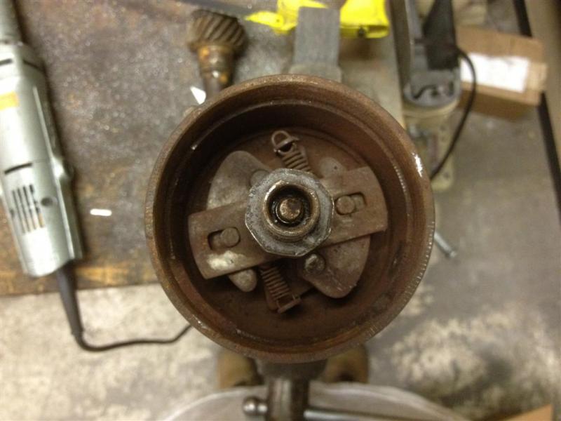

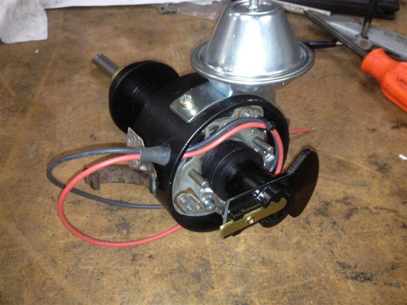

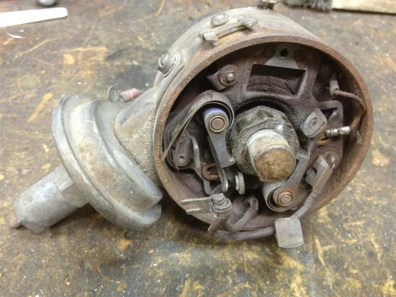

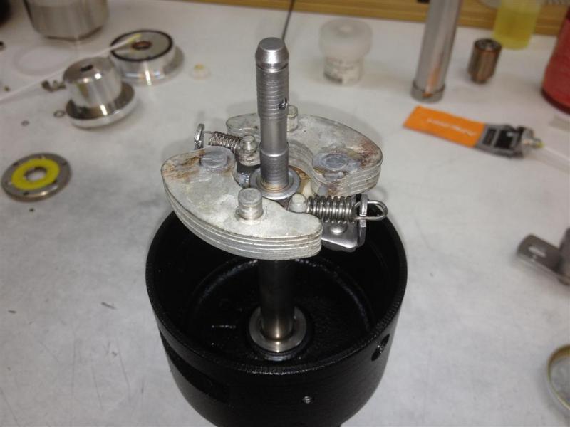

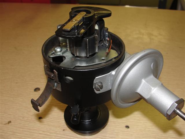

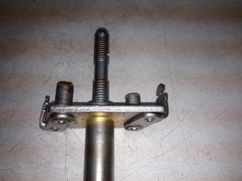

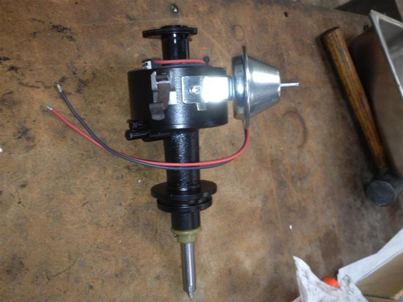

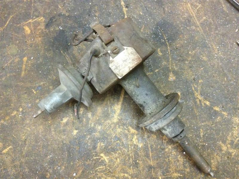

This is a 340 distributor I did for a MoPar restoration shop in OR. This was probably the biggest POS dizzy I have seen and required a lot of work to make right. In order to make this unit like new I had to not only replace the bushings in the housing but make a new shaft with an oversized pilot for the cam. It is very common for a distributor to have a lot of wear in this area. Pic of shaft by itself shows the original advance weight plate brazed to the new shaft - and phased correctly I might add. The Pertronix unit was supplied by customer and needed a little finesse to align properly. Due to the original style vacuum advance units being non existent, I had to modify the breaker plate to accept the more common late model vac advance. This was not a concourse restoration but a driver for the car owner's daughter, so they weren't picky about what vacuum advance they got.IMG_1375 (Large).jpgIMG_1377 (Large).jpgIMG_1379 (Large).jpgIMG_1392 (Large).jpgIMG_1393 (Large).jpgIMG_1394 (Large).jpgIMG_1395 (Large).jpgIMG_1397 (Large).jpg
Norm received the distributor on Tuesday & he called me on Friday to tell me that it was finished. That's the quickest turn around I've ever experienced.

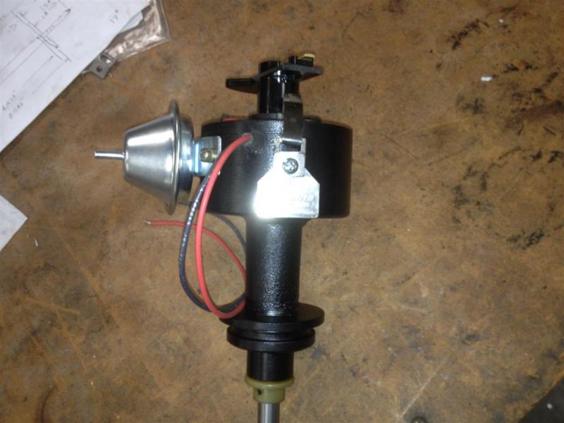

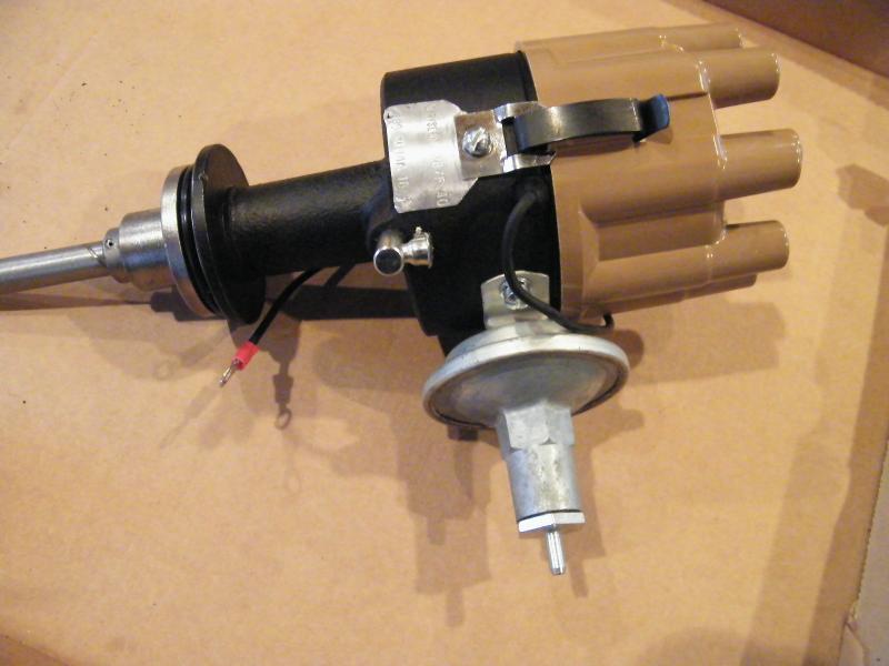

Just got the finished product back from Crossram Connection. I'm pleased.

Thanks for the follow up pictures with your experience its always nice to see the final results. Norm is one of the good guys, I would recommend his products to anyone.
