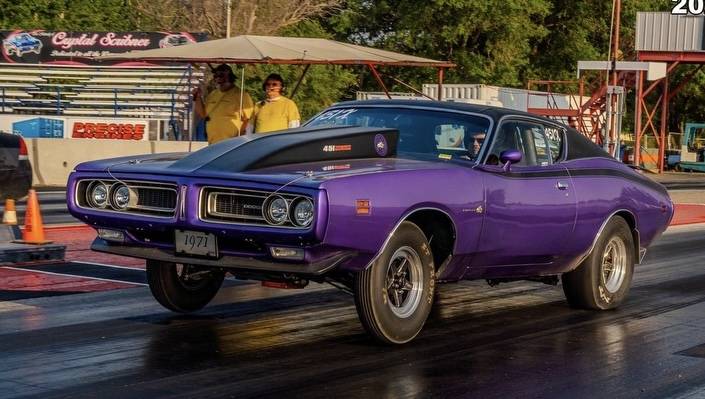

I used to run radials but run bias now. Radials about a 10th quicker on my car and nice and stable on the top end.
They are not great on marginal prepped tracks though. Also, in my big Charger I never got the life out of them that I would have liked to see. On average I only got 60 passes compared to well over 100 on a set of bias.
There is a couple at our local track who have had opposite experience to what I have had.
As a bracket racer, I’ll take the sure thing and give up ET and MPH to remain consistent.
My $0.02.
