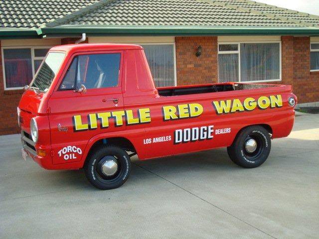

I run WV 63 series wheels and Classic Ind Dog-dish caps on my truck, and have never had one fall off. In fact they are a Bee-atch to put on, so no chance of falling off. I've done burnouts from Hell, been on a skid pan, driven hundred's of miles, bounced the front end....you name it, I've done it in that truck....well, everything except a sub-16 second 1/4 mile :headbang:

pic of my lil' truck;

Nice truck!! Had a 3 window and a 5 window but sold both of them before doing anything to them. The 5 window went to a friend that made it look nearly as nice as yours and I never saw the 3 window again.
Thanks Cranky. i pulled this one out of Arkansas just over 3 years ago. Previous owner had big plans and no cash....I helped out with the cash and got the truck :) Crate 360 runs sweet, especially now the nesting raccoon's are gone.
