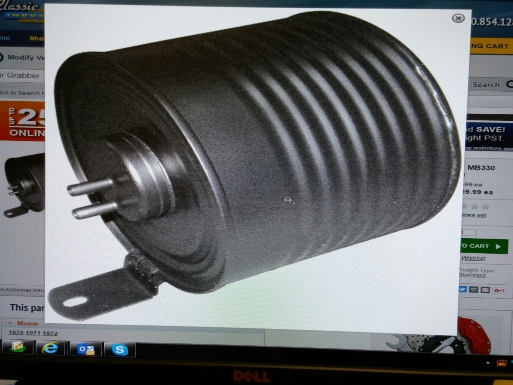

I have seen 2 types of canisters one has ridges like the photo below
and the one i have is all smooth, do you know which one is correct?

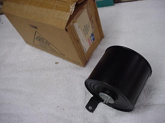

Mine is smooth like this one and it's original
Mine is smooth also
Is that brand new NOS?
And do you know where i can buy a smooth one like it?
I don't know where you can get one, that pic is from the gtx registry web site.
