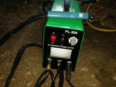

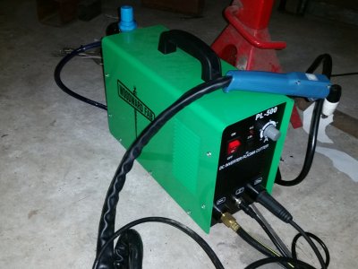

First, a couple pictures of this little unit . . . it is very compact and easy to move around . . .
Another picture . . .
I wondered how this "little" unit would work since the other ones I've used have been much larger in size ( thank you technology ! )

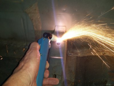

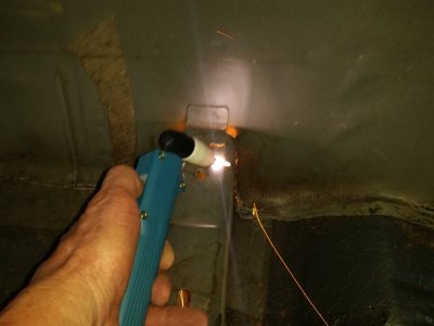

I was really surprised at the performance, and the thing cut the metal as well as the bigger ones I've used in the past . . .

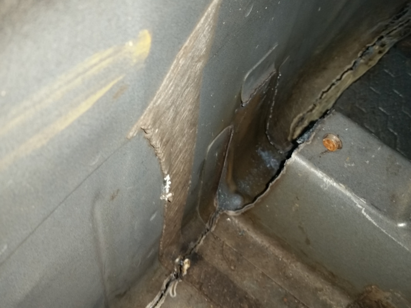

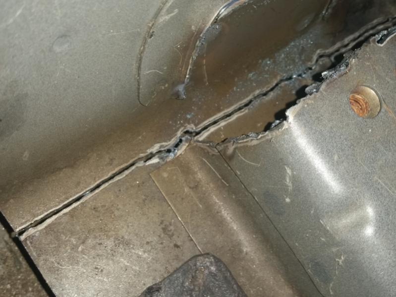

The cuts in the metal ( ok, burns ? ? ) were very nice if I kept from being too "fast" with the torch . . .
In a couple places, I had to remove extra metal, to get to the second layer of metal behind it ( and in one place, there was 3 layers of metal )
Then, after removing the extra cut, I could get the metal behind it cut away . . . ( not too bad as it can be done fairly quickly )

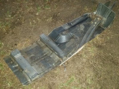

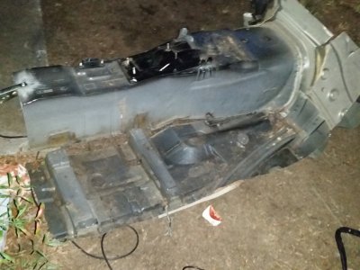

Here's the "chunk" of metal that I bought from the 2013 Challenger, to use the tunnel hump in my 67 Belvedere Convertible . . .

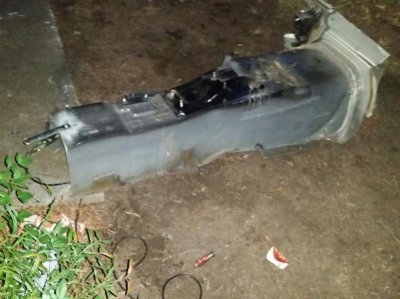

And after a short amount of time the trimming of the "chunk" looked like this . . .

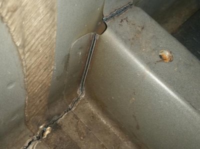

And the piece of metal that was removed . . . so far . . . it got dark and I've still got the other side to trim . . .
