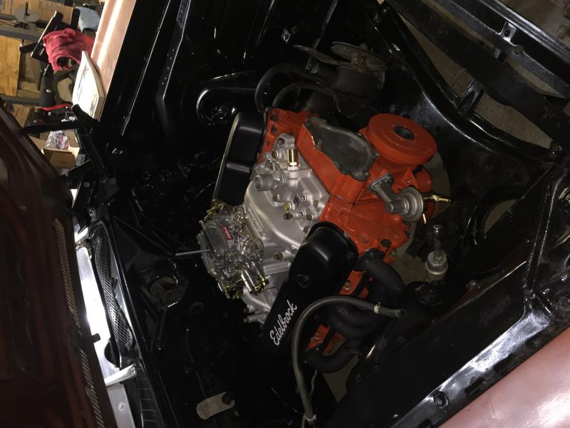

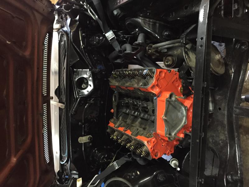

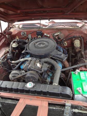

Started with a bone stock 71 charger 318 a couple weeks ago. Finished the motor, now I'm just finishing up the 904 rebuild/shift kit. Hopefully will be back to a driver (with twice the bawlz) in a couple more days.

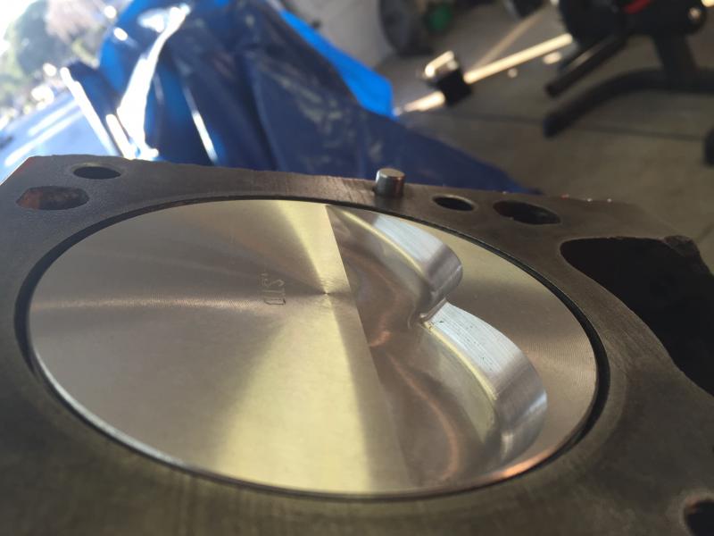

Check out the bore depth on these Keith Black 167 pistons, at TDC! Thrilled about that. Deck is un-milled.
Standard bore, swapped to "302" heads (not milled), Comp xe268 cam, 901-16 springs, Eddy performer and 600cfm carb, summit headers.
once I get the tranny back in, I will get the motor buttoned up, and I'll post a clip of the fun noises it makes.
Dont know why the last couple pics turned, but I'm posting from my phone and can't change em. Enjoy the neck stretches anyhow!
