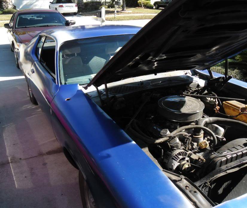

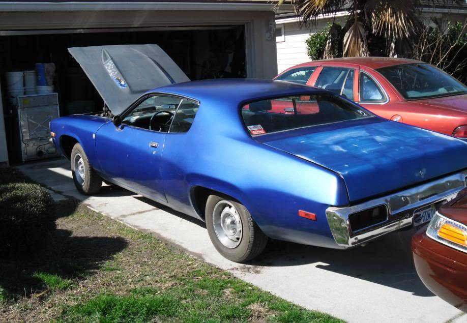

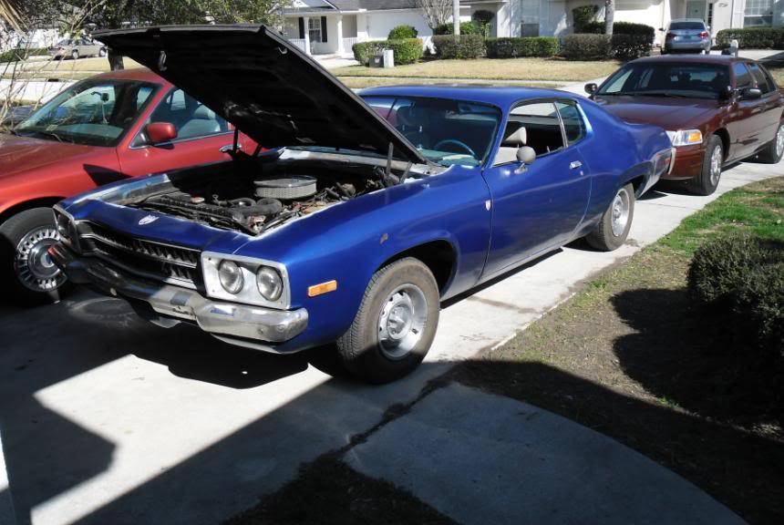

I finally got my 1974 Roadrunner back to the barn. Had a nice drive from Hawthorne, FL to Fleming Island in it, and it sure was nice to be behind the wheel of a 73/74 Roadrunner again... and even better to do it in a car I paid $2,000 for and was able to drive home instead of tow. :)

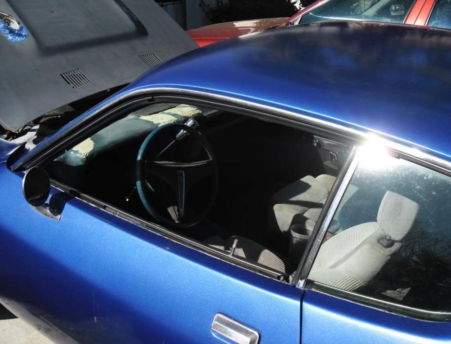

The car is a 318 auto that now has a warmed over 360. The drivetrain is fine, but I've added an Accel supercoil and wires. Body is in great shape with a few small spots of rust bubbling up on the lower driver door, and there's a dent on the fender that need to get pulled. Everything else is just a couple of supermarket dings. You can see the leaf springs are worn and the shocks were totally shot, so I've ordered new leaves and put a set of Hijackers on last night.
The car has a new fuel tank, fuel lines, exhaust, alternator, and PS pump. Downside is the door panels are there but most all the interior from the doors up is missing.
The original seats are gone and replaced with some SUV seats that are going out this weekend. I just bought a nice set of seats from a 76 Aspen that will be going in. Cost: $40. I've also gotten a complete console shifter setup that I also plan on getting in this weekend.
Paint will be black enamel with black and gold stripes to refect the Pittsburgh look I'm going after.
I hope you'll keep us updated as you go, thats a cool decal there for sure... I learn something new each day hear, i didn't know you could have them made up, It is real isint it? with what your planing, they would look great on it! Looks like its in great shape. Your car looks familiar, the color, mine is a 73 RR clone but as you can see it reminded me of mine before i tore into it, if you look close, it has the same coil you put on yours, lol.. Sounds like you had a nice ride home in her, thats always a winner.. The colors you have planed sound awesome... Wish ya luck in your resto!! Ill be watching.. :)
