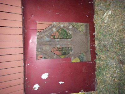

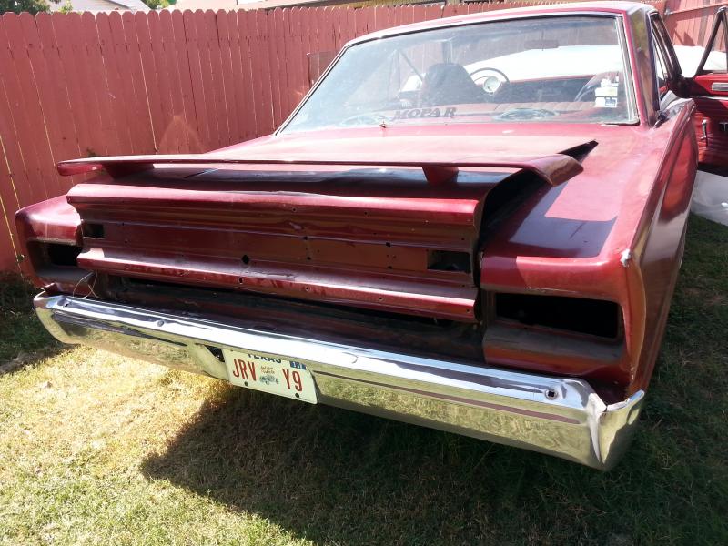

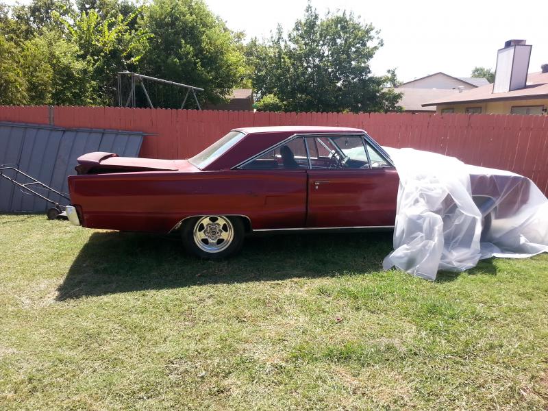

So it begins!! I put the R/T in the backyard last night so I can start disassembly and repairs. I'm not going for a total restoration, but just want to repair some of the rust issues that I have found. Replace some of the rubber seals around the doors and trunk. And get ready for paint and new carpet. I hope the rest of the floor is in better shape.
I can't decide if I will put the wing back on. Not sure if I want to put holes in the lid it took me so long to find. As you can see its mounted on a 66 trunk.

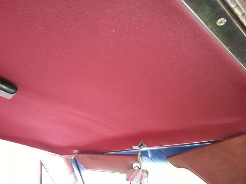

Headliner pictures
Here are some pictures of the headliner I did last month. I forgot to post them. Still working on an idea for the joint at the sail panels.

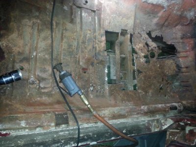

patch panel

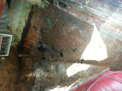

Well the section I was going to use from the Belvedere is not much better so I'm going to cut a panel from an old trunk I've been saving. I'll have to bend and shape it to fit. Fun fun fun. More to come!

Gonna be a great car when you get it repaired and painted. Ditch the wing, just doesn't quite fit the body styling imo.

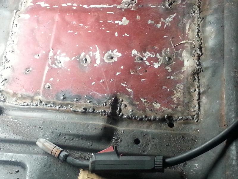

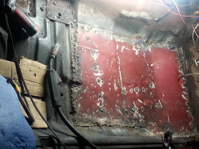

Floor patch

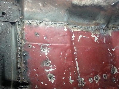

I finished welding up the floor pan tonight. Now I need to grind down the bigger welds. It took me a while to figure out the wire speed to get a good weld, but it's a good solid patch. I beat on it with a 4 lb sledge hammer and it sounds good and solid. Not to bad for a Harbor Freight special. More to come, hopefully the driver side is better.

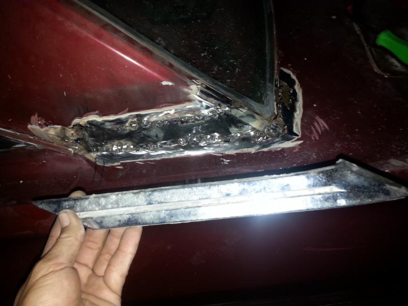

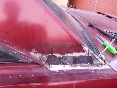

Sail panel repair

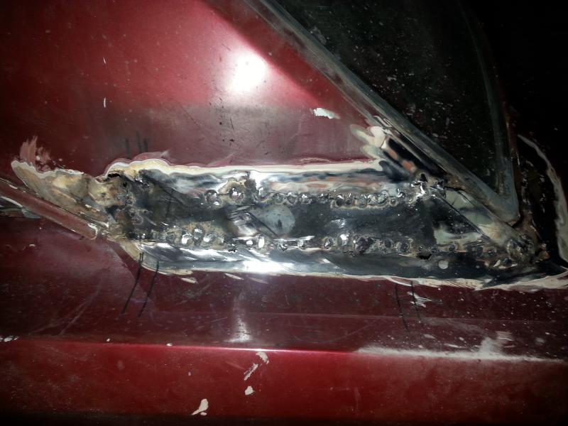

Yesterday and today I worked on patching the driver side sail panel where the chrome accent goes. I need to find another set of the chrome accent pieces, if anyone has a set they will part with PM me with a price, Thanks. More to do tomorrow.

How did you do that weld without removing the glass?
I had to pre bend the angles to match the sail panel angles and molding chanel all together. It took a couple of trys to get the chanel part under the rubber. And still was only able to tac it at the bottom corner. I'll have to wait until I remove the windshield to weld it to the seal Chanel
The answer would be very carefully and slowly , as not to heat the glass. They do explode ,trust me amateur mistake once wasn't even welding to the part the glass was mounted to it was just very close and boom! I'll never do that agen .
