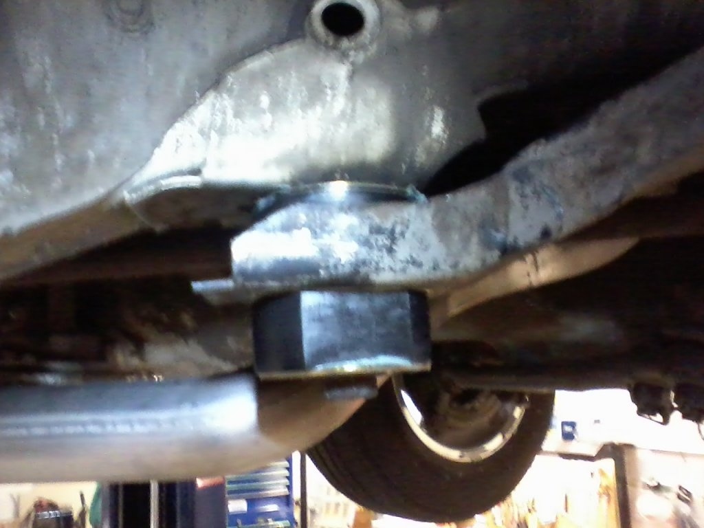

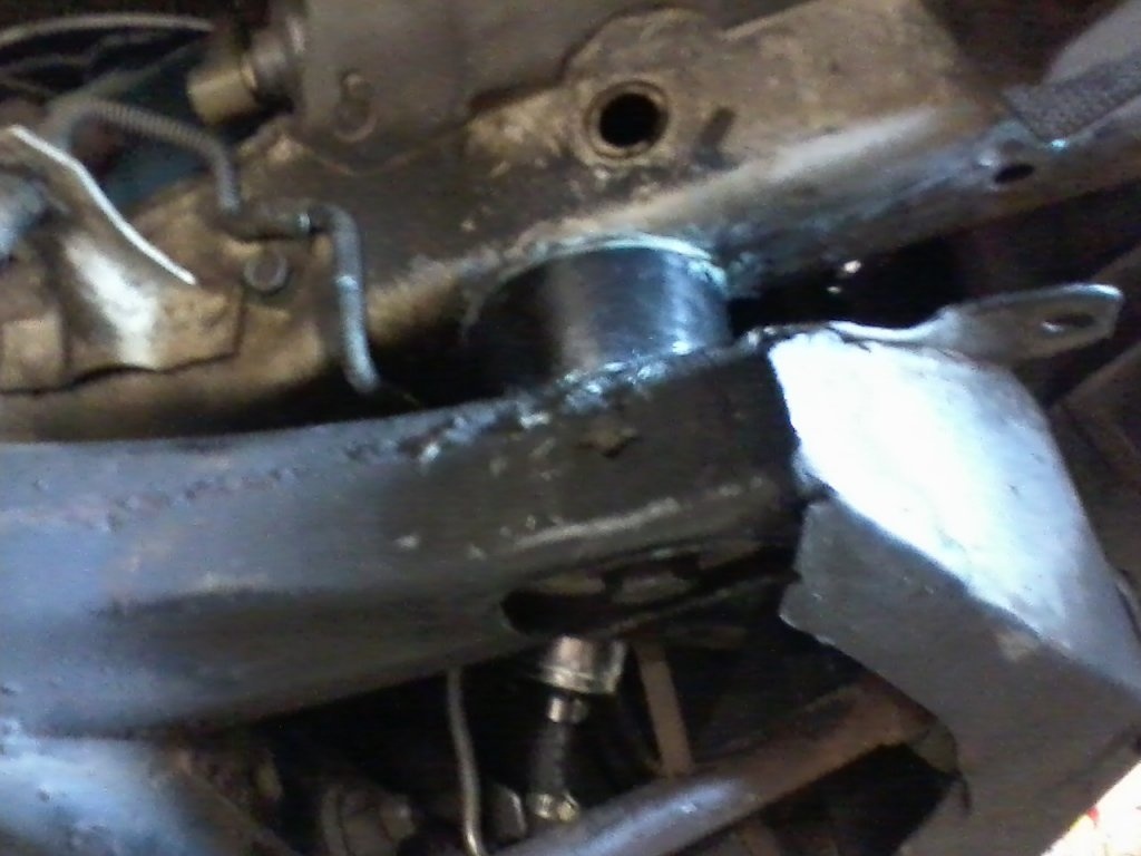

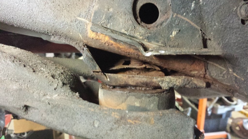

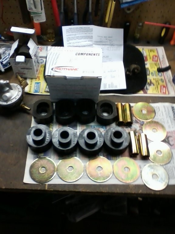

This weekend I replaced the body to front frame and torsion bar mounts.The car is a 79 300 "B". The part # for the body to frame is 4-101-BL and T-bars is 4-106-BL from Summit.Cost was less than $100 for the pair. The T-bar bushing install took about 10 minutes. The front frame bushings took about 2 hours total as we had to cut the center support sleeves with a saws all .Sorry for the crappy photos(cell phone) misplaced my good camera %$&&^ !! Still didn't find it ! Drove it today and it did make a difference with the handling for the better.Still has a nice ride. Saving up to do the rear bushings and springs.

I found, like you did, that I lacked about 5/16" to clear that center tube and top plate piece.
This was with the bolts out on that said and the other side loosened almost all the way.
I think separating the ball joints might get me another 3/16.
I was scared to cut that part in case I needed to put it back like it was for some reason.

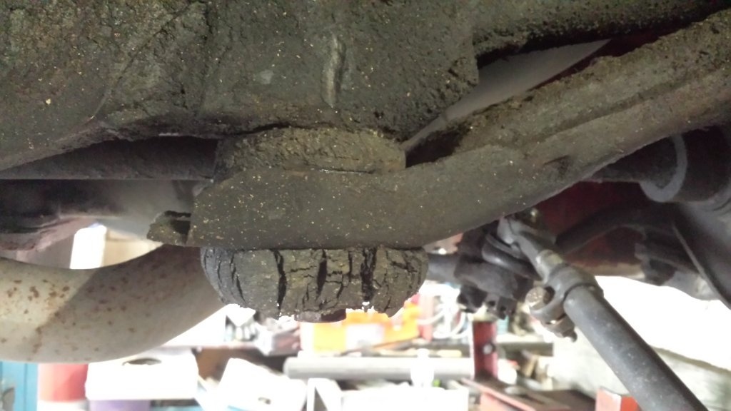

What is that in pic #3? Is that the trans mount? I only have the K frame kit.

The first photo is the torsion bar mounts new on the left old on the right.
Photo 2 is the new frame mounts,3 is the frame mount showing the cuts to get it out of the frame and clear the body.

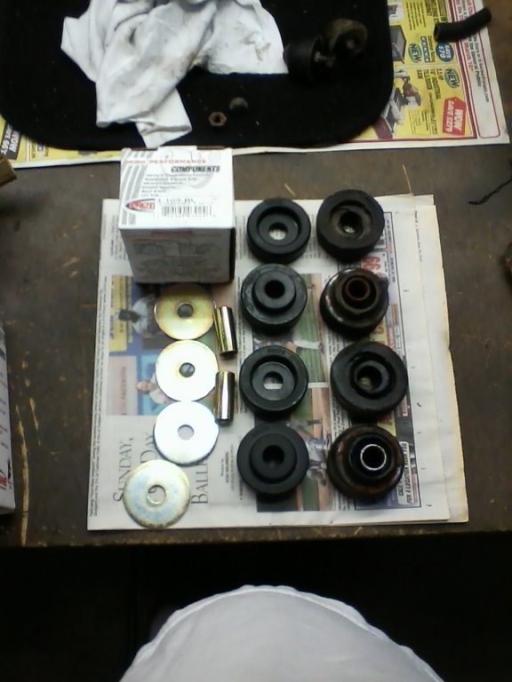

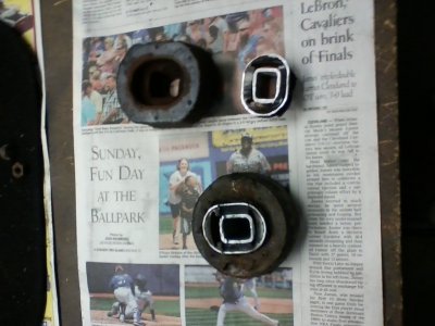

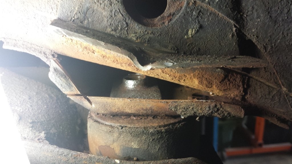

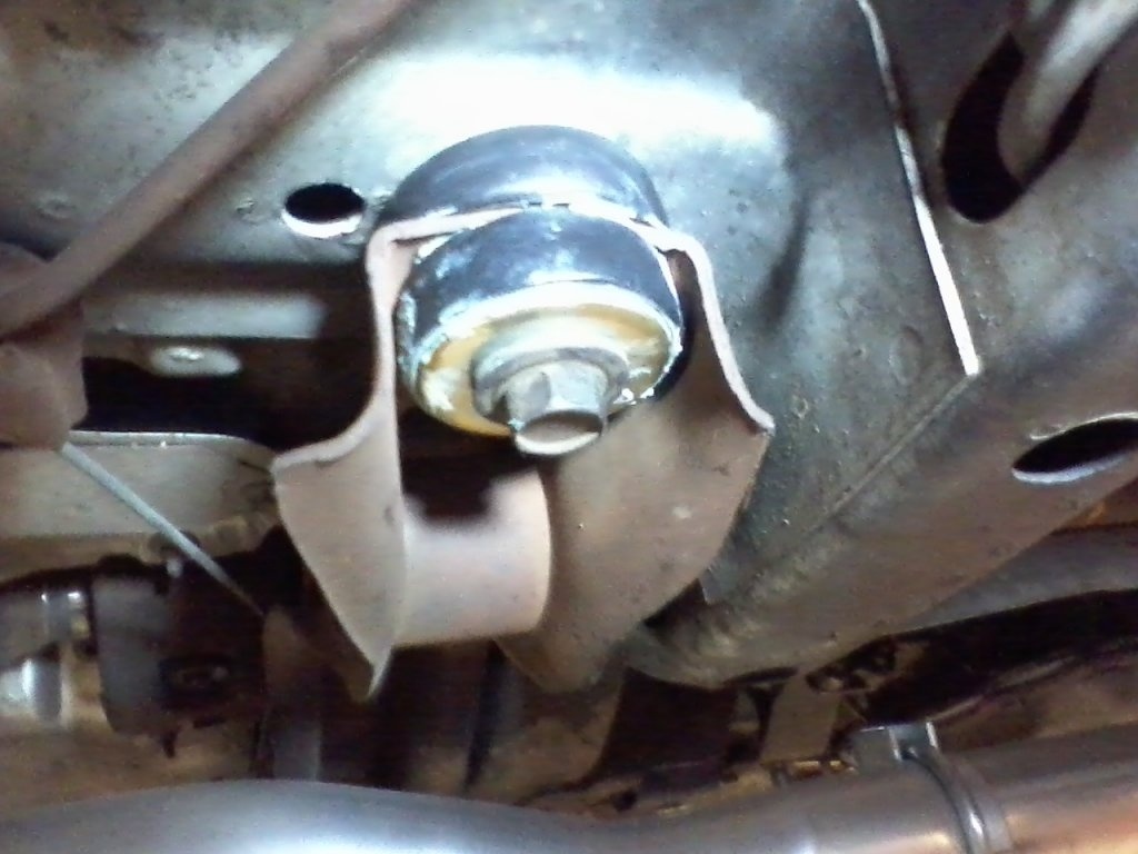

Photo 4 and 5 are the new body mounts installed.

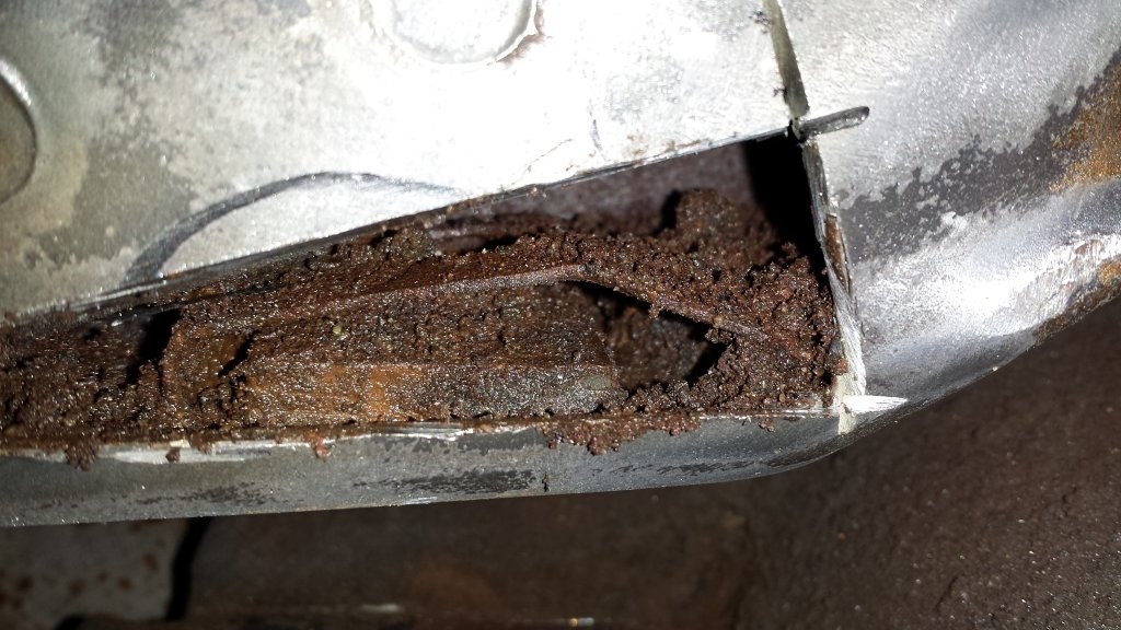

Photo 6 is the torsion bar to body mount.
I used a waterproof marine grease for all contact points.The guys over on FMJ Bodies said to lube them,those that didn't got squeaks.

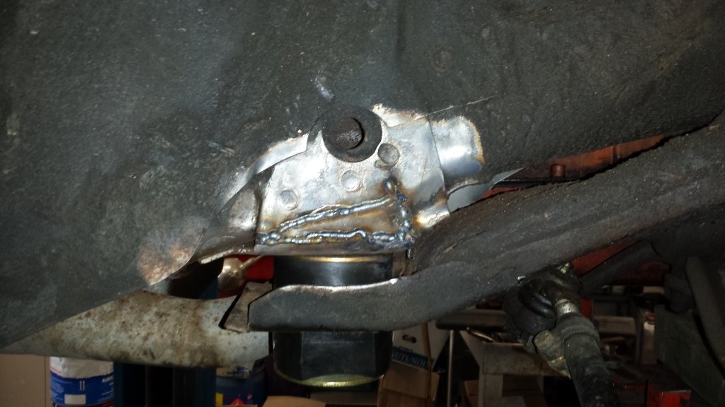

The K-member bushing where kind of easy......the front one where done without any struggle but the rear one where a little pain in the butt since the castle nut spun inside the little pocket.
I had to open up the side of the pocket/gusset to remove the nut/bolt and welded a locking tab on the nuts to make sure they will not spin when I thight them up.
I just remove the upper ball joint from spindle and the upper control arm plate from the K-member (I replace the upper arm bushing) lowered one side at the time (slowly and carefully) and was able to wiggle the old bushing out without any cutting

!looks good I did my body mounts on my 73 Charger in 2002 it took me 5 hrs. one side at a time removed the strut rods and pryed up on the frame. Some rust was present, I added a new thick aircraft aluminum plate custom cut to fit the bushings and coated it with asphalt. to prevent reaction with the steel. The bottom frame that was a bit rusted, still strong so it does not need welding, but some day I will have a welder rebuild it completely, Every year I spray wd 40 in a hole at the rear body bushing mounts to keep water out of the bolt and weld nuts. Poly bushings made a noticeable difference in the cornering. They will not move and squeak if they squeak than they are not tight enough. min of 250 ft lbs is what the Shop manual reads for those, and the Just suspension tech told me to tighten to factory specs. I cranked in them until they stopped. slightly bulging is good.
