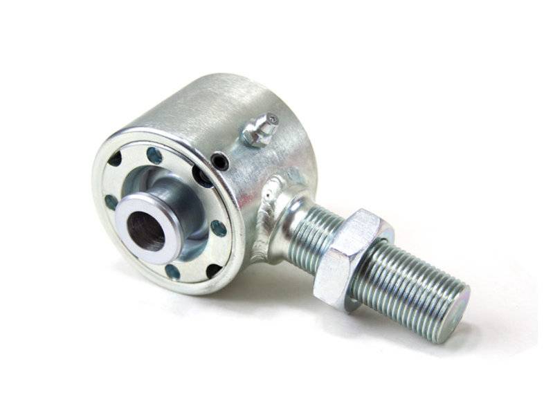

Anything got to be better than the heim joints. Bio put up a pic of his and it has a grease zerk on it. That's why I'm looking at those type.
I wish umi did those for mopars . I think having a grease point would be best .. Bergman doesnt use greaseable lca . And recommends the qa1 upper arms , they are poly bush and greaseable

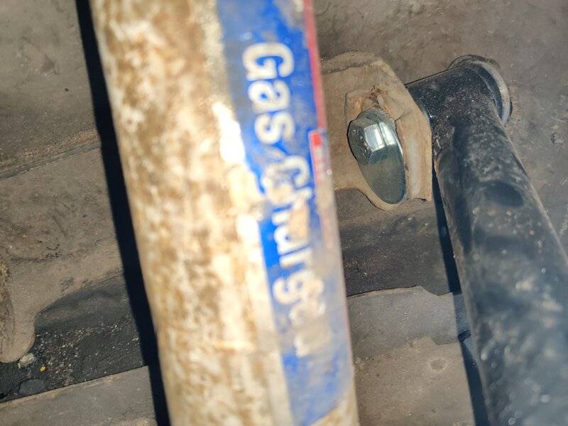

PST doesn't mention that you will need to modify the upper a arm brackets as they may/will interfere with the tube arm and prevent the proper camber settings (see in my attached picture) When i asked them about this, they said that sometimes this is an issue (would have been nice to read that on the website before ordering so i could plan for it).

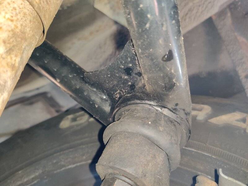

I do like the design of the arm, with the extra caster built in, and it certainly seems stout. One of the grease boots was bent a little and didn't sit properly which i didn't notice until i had them in the car. (See my attached picture of the boot with car sitting on the ground)
The DELRIN bushings squeak really loudly, like the styrofoam my stereo came in, when it rains. Luckily it rained the day after I got the alignment done on the new arms and i brought it back in, squeaking like a stage coach, and my local shop (Tru Line in Seattle) put zerk fittings on both sides for me. They did note that in a perfect world, they would also pull the bushings and carve channels in so the grease would have several places to go, but as done it did quiet down almost totally after they installed the zerks. The next day it was silent. I would argue that an even more perfect world would have PST design these with zerks and channels from the get go! Tru Line did say that they like DELRIN and it should last for a LONG time.

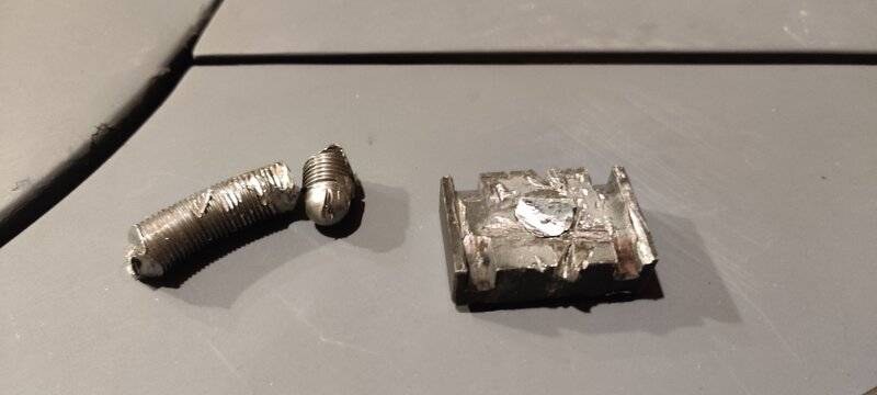

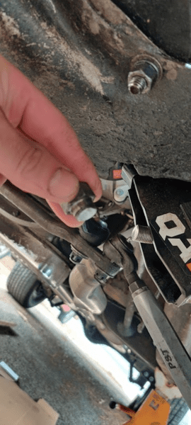

I went through several unanswered emails about the grease boot i mentioned above and some of their torsion bar adjusters (which stripped when adjusting with wheels in the air, leaving me to spend 2 hours air chiseling the broken bolts out to be able to put my original Chrysler bolts and adjusters back in, see attached pictures). They did send me replacement adjusters and bolts, and the replacement grease boot, but I'm dubious about using their stuff in the future. I see that most people on this forum have had a good experience with them so it's always possible that i was just really unlucky! Their 1.03" torsion bars seem great after 9 months or so, so maybe all the ball joints will last for years. We shall see.
Hope this helps and I'd love to hear anyone else who's used these arms report on their experience!!
