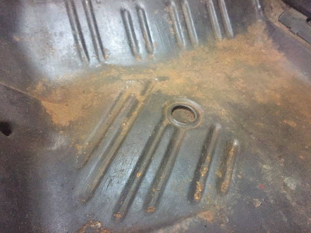

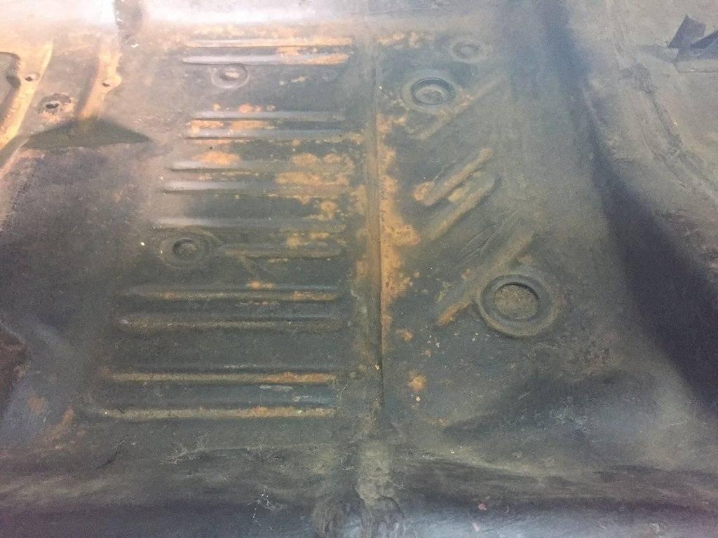

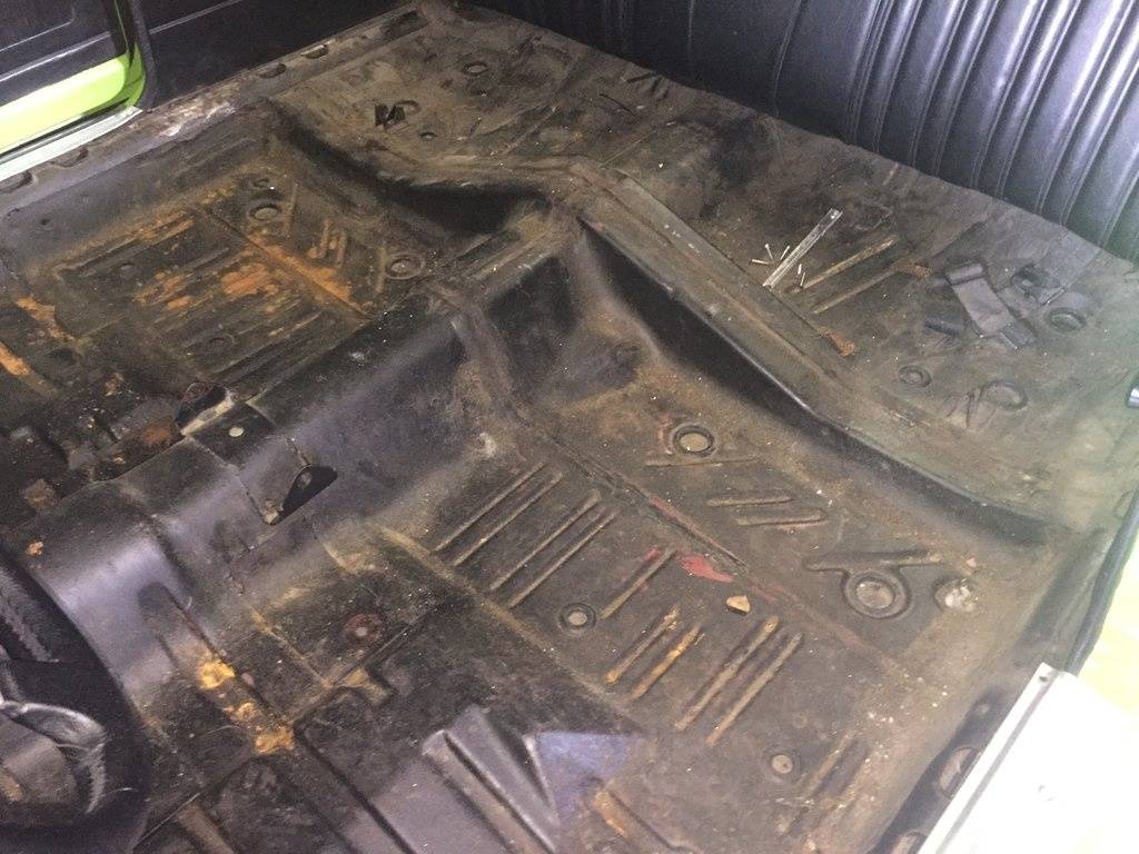

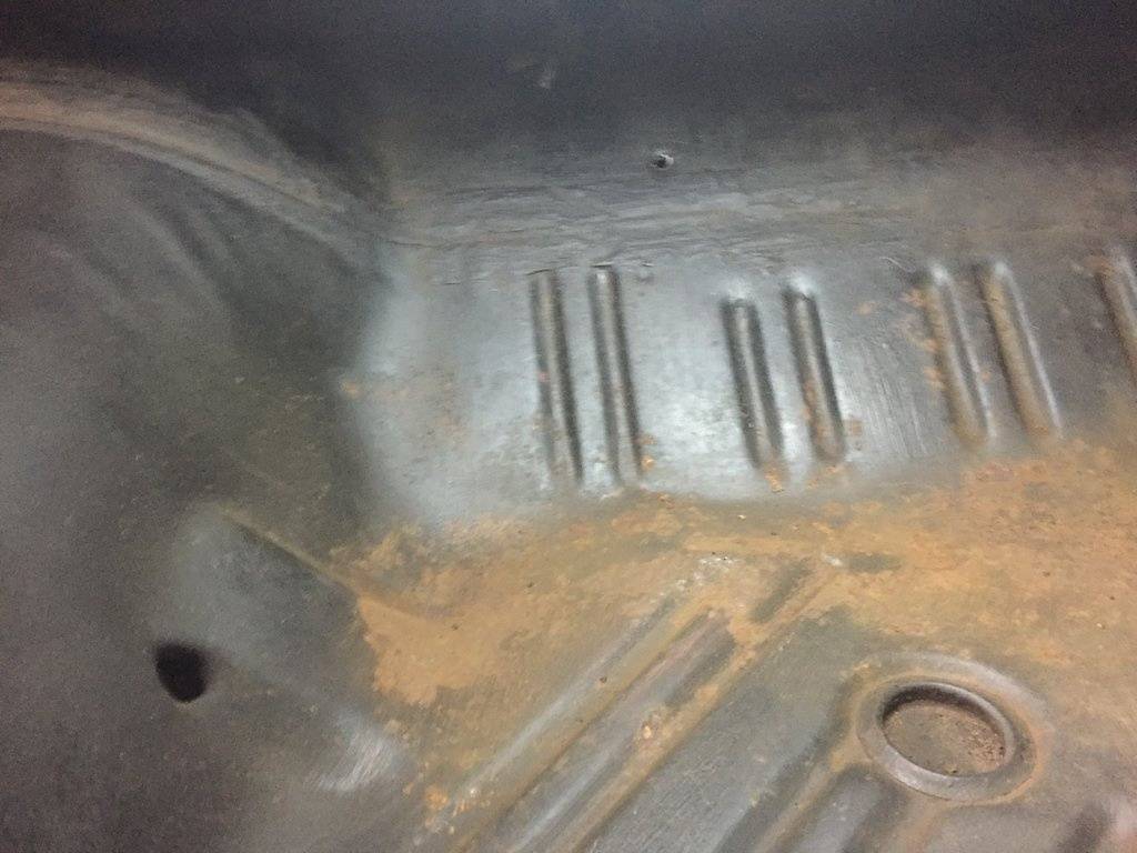

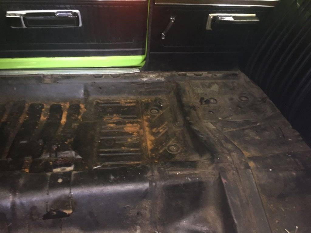

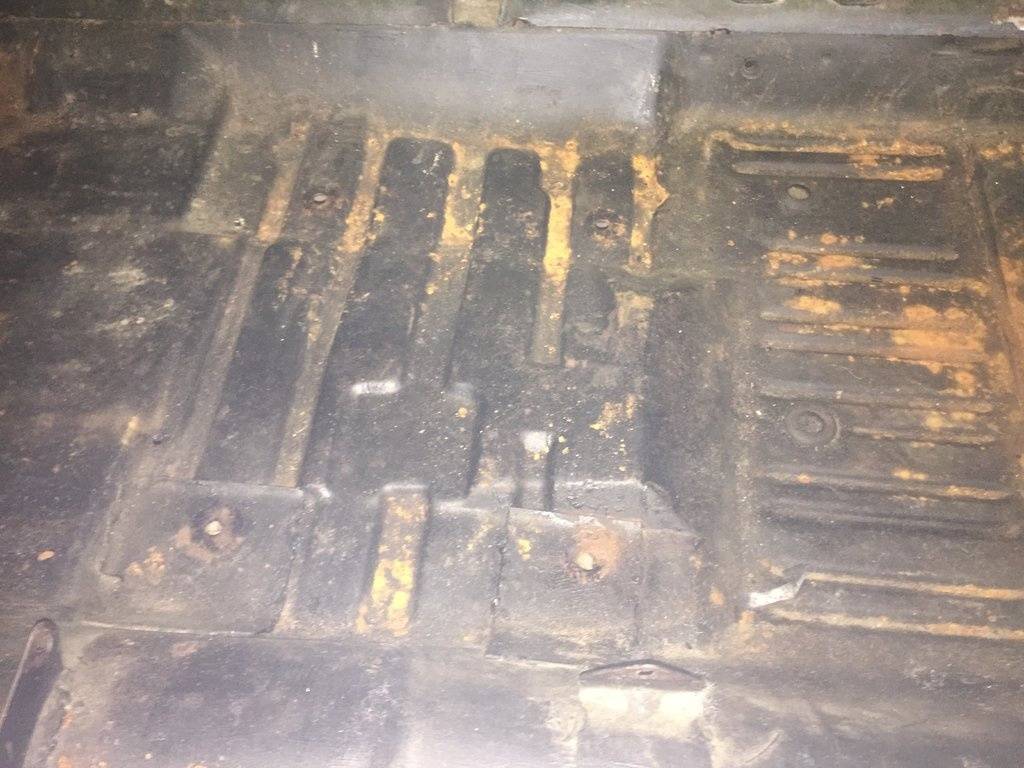

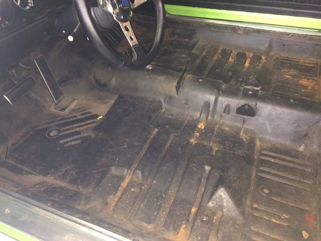

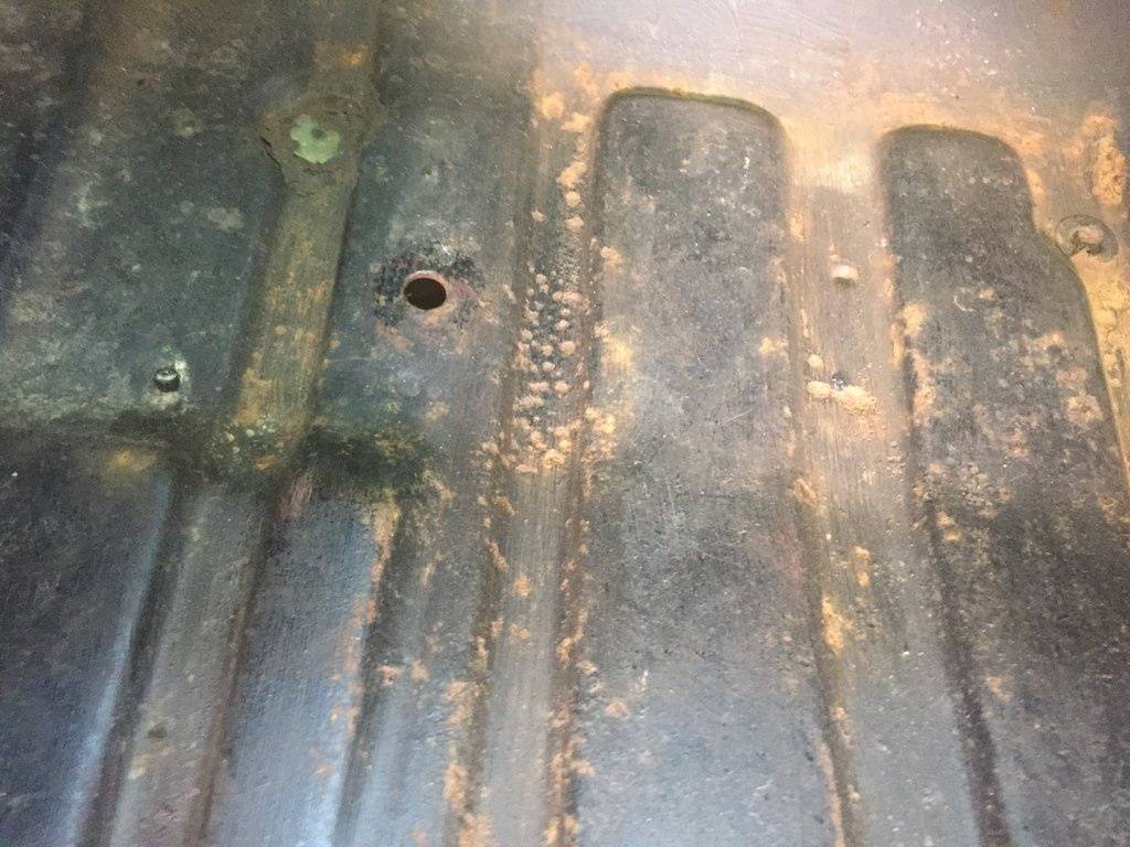

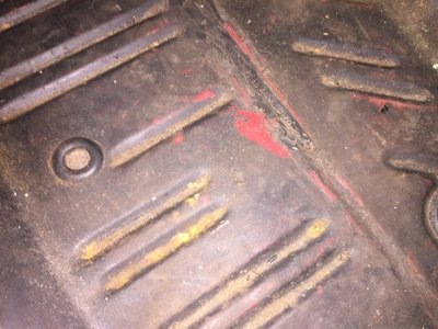

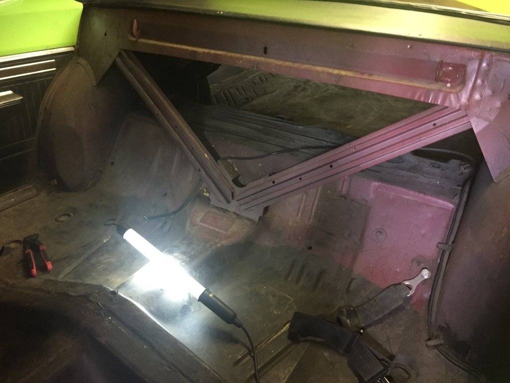

Hey all,
Today i made a start to check and preserve the inside of the car so pulled all interior and the carpet.
Rust found is not bad at all, some places on the passenger side have some pitting but to me not worth it to replace the sheet metal.
See below pictures, i did notice sealant running across the bottom against the fire wall and near the rear seat foot well.
I wonder is this because the floor has been replaced before or is this originally like that?
Oh yeah, by the looks i think the car originally was R6 red??
IMG_8267.jpg IMG_8268.jpg IMG_8269.jpg IMG_8271.jpg IMG_8272.jpg IMG_8274.jpg IMG_8275.jpg IMG_8276.jpg IMG_8277.jpg IMG_8278.jpg
Wire brush and POR15.
Agreed. That floor is actually pretty decent - and yes, the factory often slathered sealant on seams like that.
Clean 'er up real good, then lay the POR-15 to it. Done deal.
