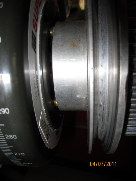

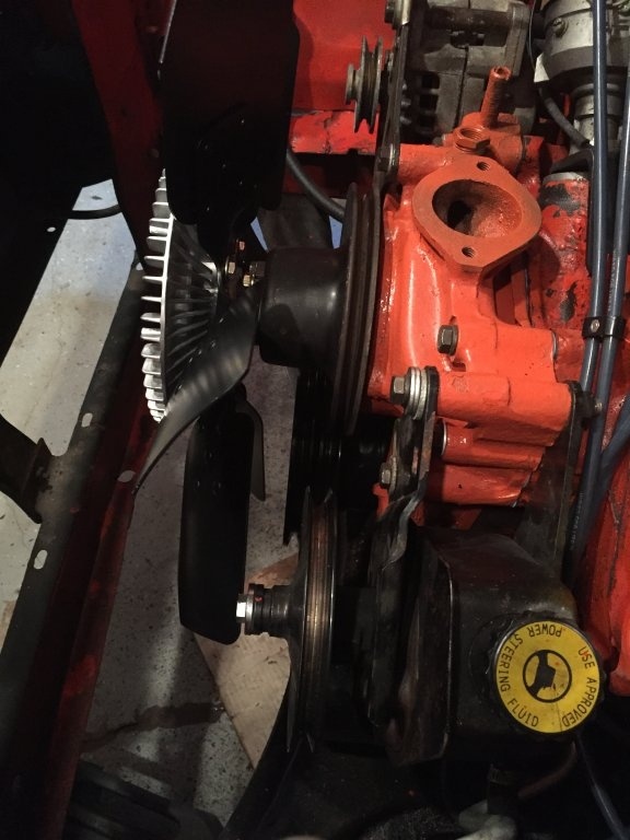

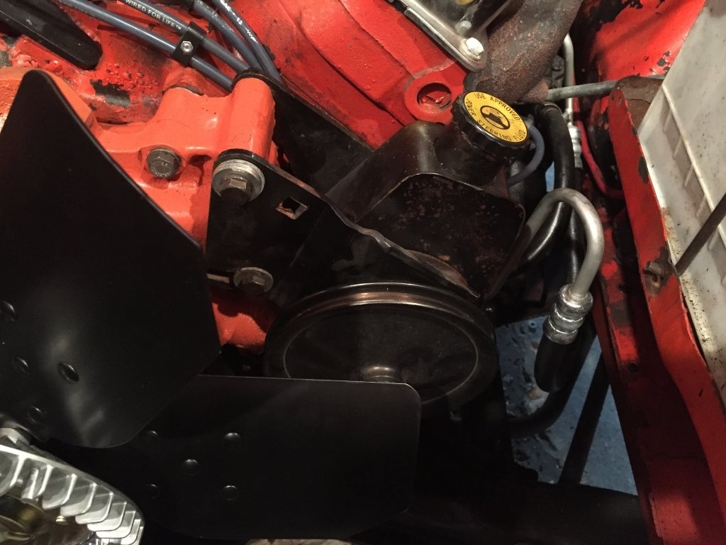

Here's the quick story:
Swapped out the gear drive for a timing chain on my 440, and I'm putting things back together. During disassembly, I found that the balancer had a huge crack in it and a chunk of it looked like it was about to fly off. Second, the crank pulley was really banged up which I knew already, so I replaced it. I bought a new balancer and pulley from 440Source. Now the Power Steering pulley and the crank pulley are out of alignment by about 1/2". Basically the PS Pump Pulley needs to move forward about 1/2" and all should be OK. It might have been a bit out of alignment before, but it wasn't noticeable. You can see that it's out of alignment now. The alternator/fan/crank alignment is fine however.
Is the PS Pulley on correctly? Do they make PS Pulley shims? Any other ideas? I'd hate to start replacing more parts so let me know if I've done something wrong. Especially since the PS Pump is working fine, doesn't leak, etc..

I understand the PS brackets/pump doesn't move, but there has to be a way to adjust the pulley itself or swap a spacer in there. I have to assume that I'm using the right balancer and lower pulley, especially since both are from 440Source. At least they should be "matched". Both are "factory replacements".
If I'm going to space the lower pulley, it needs to move back into the engine more, and I'm pretty sure that's not possible. Catch my drift?
So I guess the pully from 440 source doesn't match the one you took off? Or is the difference in the balancer?

Yes that's what I was thinking too. I was just staring at it and figured if I shimmed in between the bracket closest to the engine block and the pump body that would move the entire pump forward enough to line things up. For some bonehead reason I didn't realize I could do that when I posted earlier. Not enough coffee I guess.

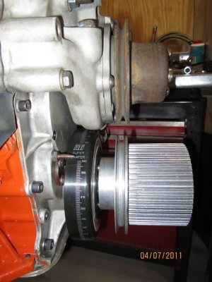

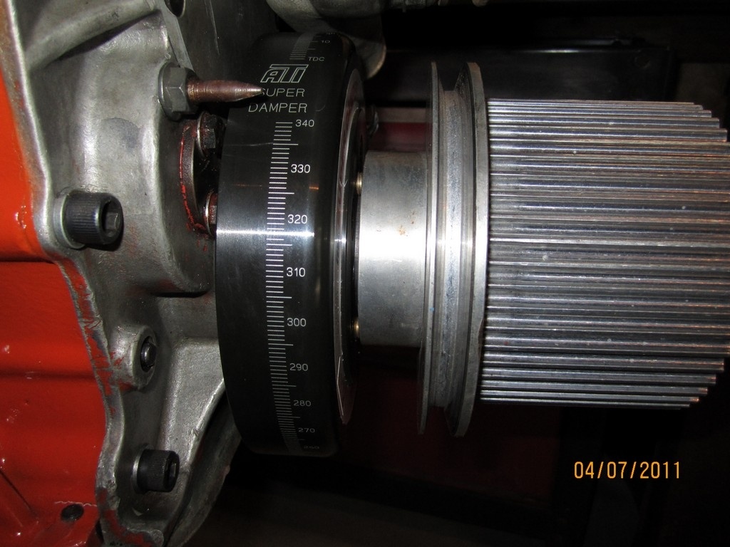

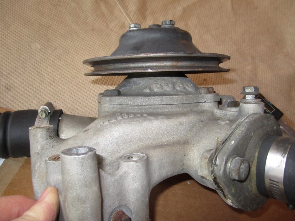

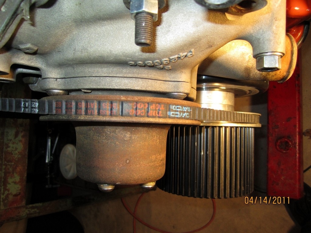

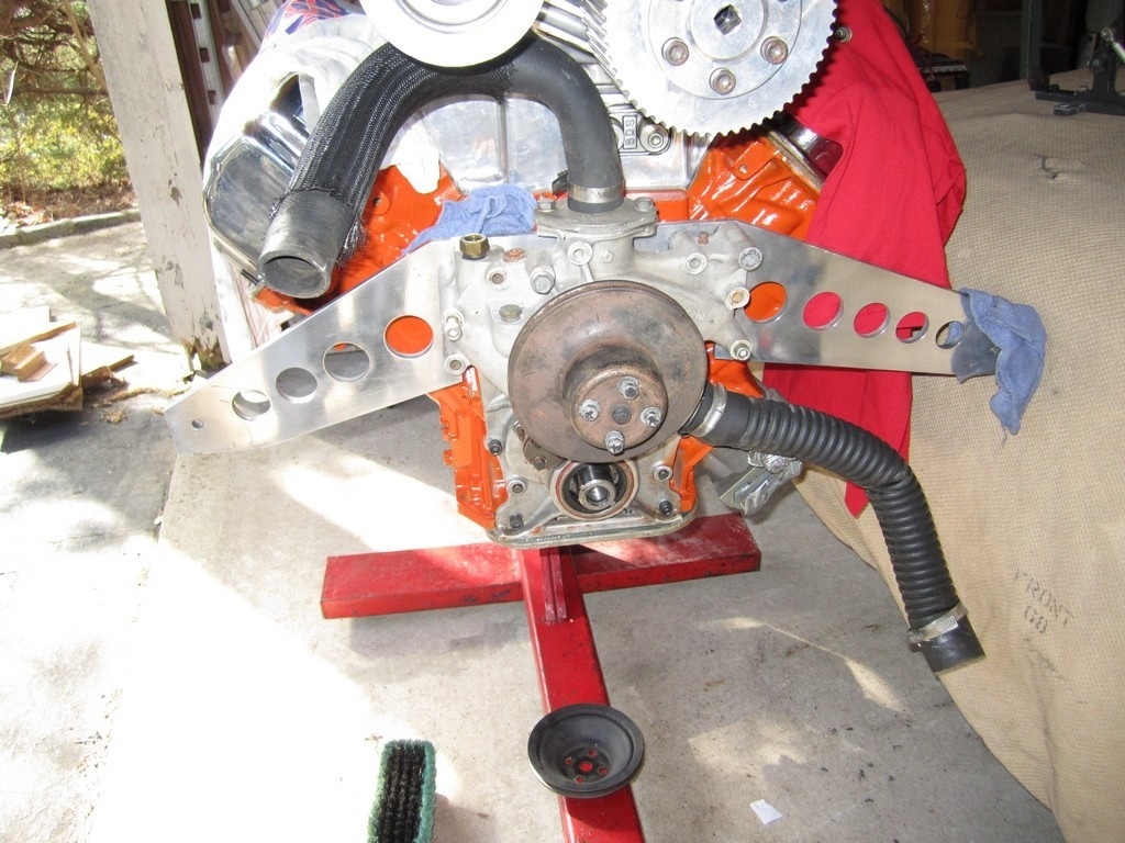

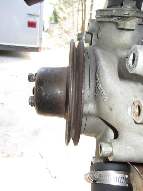

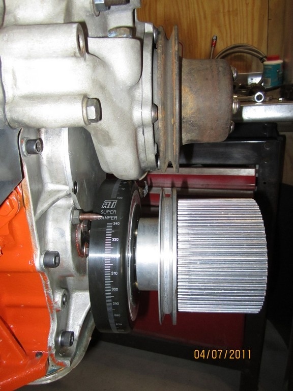

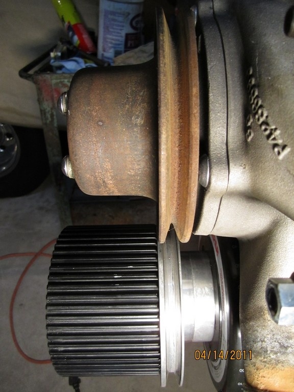

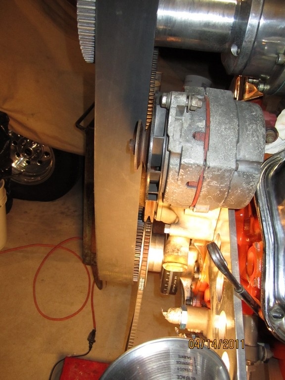

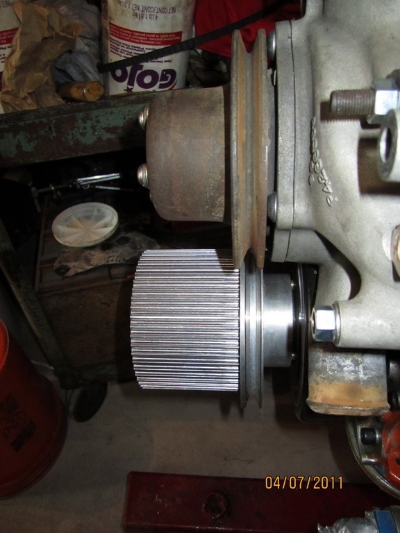

Different ways to space stuff,,,,,,,,,
4.7.11 (4).jpg 4.7.11 (5).jpg 4.7.11 (6).jpg 4.7.11 (7).jpg 4.14.11 (2).jpg 4.14.11 (3).jpg 4.14.11.jpg
Can't quite make it out, in your second photo...
So, I'll just ask. The front end of the p/s pulley should be flush with the end of the shaft, is it? Might check the SM on that, but almost looks like the pulley is set too deep. About the same set-up on my 440, p/s belt should go on front crank pulley groove.
Look into a water pump pulley for two belts. A short belt from water pump pulley to power steering pump pulley only.
You dont really want to space out the water pump pulley. Cause that register has to engage the fan properly. If it doesnt you could have big problems.

Hold yer horses. A new dampner is made slightly undersized in the bore and should be honed slightly to get the correct press fit. Therefore moving the dampner and pulley back into the motor. Is the dampner close to the timing cover? Did the dampner come with instructions? Did you do this already? If so,never mind this!
It looks like the WP,crank & water pump all line up. Just the PS pump is off,,,,,,,,

HEMI-ITIS once its all together I will post pics for sure. Basically I'll be shimming in between the pump and the bracket. I'll have long enough bolts to make it work. I really only need a 1/2" to align things up.

Cool. The reason I said that about the PS pump,the way it's mounted I don't see how it can be moved forward or back.Looking at you pic,the waterpump and alternator line up,,,,,the only thing you changed was the dampner and crank pulley.Was there2 belts?? One for the WP & alt and one for the powersteering?

Well that's the thing. It really wasn't lined up, and the crank pulley was out of whack You could see it spin and be wobbly, hence my replacing that part. The PS Pump was close but not wobbly. It might have been a little off before, I never did really look at it that closely. But you can clearly see it's not lined up now.
