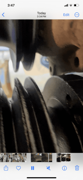

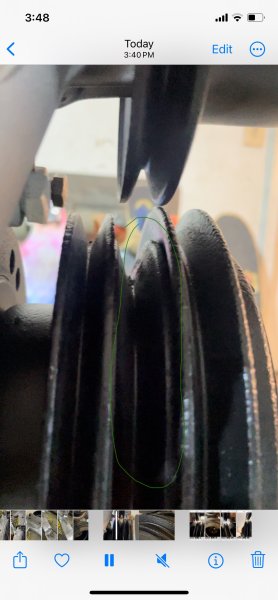

I reassembling my 318 and am a bit concerned about the clearance from my crankshaft pulley and fan pulley. I purchased a w/ac water pump (didn’t realize it was w/ac when purchased)”the one that seems to be to close” no rubbing but less than 1/8”. I attached the old one (not reusable) and had much better clearance. My question is what should the clearance be and if this is an issue? Thanks
2 pics of each
Probably just need to get a new pump w/out ac. oe replacement
Changing the water pump can not do what you are saying, it should be in the exact same position. Doesn't matter if it's a/c or not, same position.
Hmmm? Well there is in fact a noticeable gap between the new acdelco and the old rusted pump
A/c cars have different pulleys and the belts run in different positions. I didn’t think there’d be a difference in the pump itself though

Is the center cog in this photo belt usable or is it just a gap?
