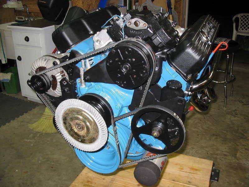

Mine has a 2 groove alt, but single at the water pump. So 2 belts run the alt only. Crank to alt, I think the 2 rear ones. The 3rd one goes crank, water pump, power steering pump. 3 pulleys. You only need 1 on the water pump.
They also make cheap spacer kits to put behind the water pump pulley if it doesn't line up right with the alternator and other things. Good luck!

I used thee viscous fan package pulleys used with a AC car. Smaller waterpump pulley. Was a pain getting everything lined up but can be done.

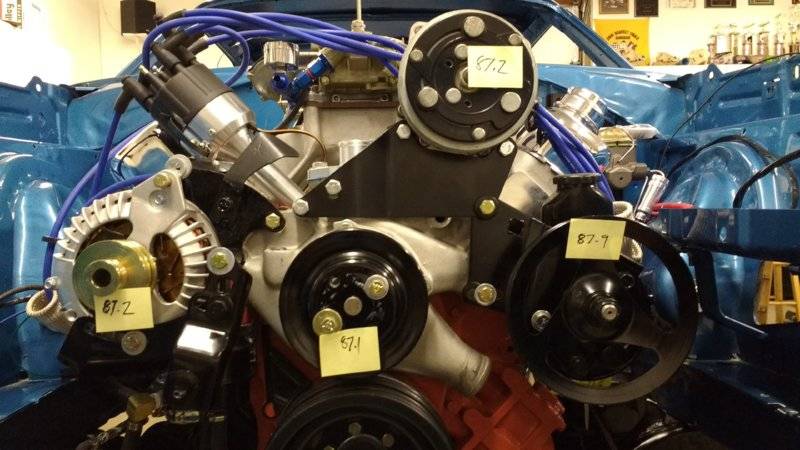

You can run the alternator with a dual-belt and the water pump with a single, as Gary stated above. The 440 source website has a chart with factory pulley numbers maybe it'll help...
The FSMs also show the various drivebelt routing setups for the different engine/accessory configurations. You can download different year manuals and diagrams at http://www.mymopar.com/index.php?pid=31
I've been told that AC and non-AC water pumps have different length spindles.
That certainly could explain what I like to call "PULLEY HELL" when dealing with parts and pulleys that did not all come off of the same donor vehicle.
So, I'm just guessing the Proform (and other knock-offs) and Mopar Perf aluminum water pumps are same length spindles as a factory non-AC pump?? I know they are the same as an original factory aluminum race hemi pump for sure, and Im pretty sure those didn't come with a/c.:bananadance:
instead of running a dual V-belt have you put any thought into converting it to a wider serpentine belt? I know 440source makes some affordable pulleys to convert to them
I am currently debating the same thing - I don't think PS will work on my set up so is it easier to just get a new matching set of pulleys or find the one random pulley I need.
I don’t see anything about serpentine systems on 440source
Would the 440 source serpentine system require a reverse flow water pump? I have their “high flow” aluminum pump and housing
Shouldnt require a reverse rotation pump - it is not a single belt system which commonly turn the water pump with the back side of the belt - instead it is a replacement pulleys that work the same as stock - just utilizing the wider 6 rib belt (These are a lot like the old March pulley sets)
