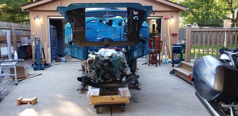

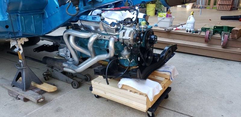

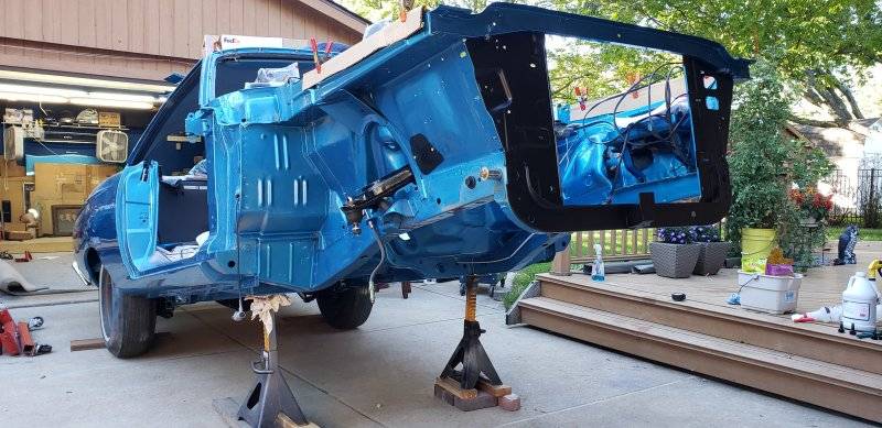

It will work if you lift the car off the K-member with engine attached.

Typically you might be able to remove the header bolts from the heads and squeeze the engine out. Hold the headers in place with bungees, wire, etc. You may have to remove the starter half way and it will depend on how your exhaust system is built. It's worth a try.
Only have an engine hoist
That is an engine hoist lifting the front of the car.
The only way you’d remove the engine with the headers on is to do what kiwigtx shows. It seems a little daunting at first but it’s pretty easy to drop the whole k-member. 4 bolts for the k-member, undoing upper ball joints or upper control arms, 2 brake lines, transmission x-member/driveshaft
