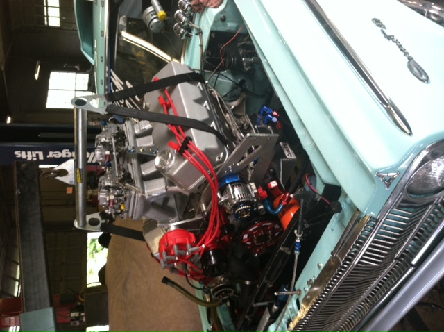

Get one of these and eliminate the motor mounts.
You can lighten yours up by boxing it Jimmy can help you out with the welding
You know I'm on a diet!
Get what? A 600" hemi?:)

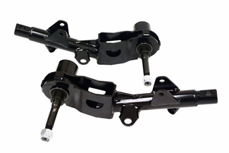

& the original Capps Automotive {still new in the box} Lower Control arms
QA1 makes them too, even with the sway bar tabs on them

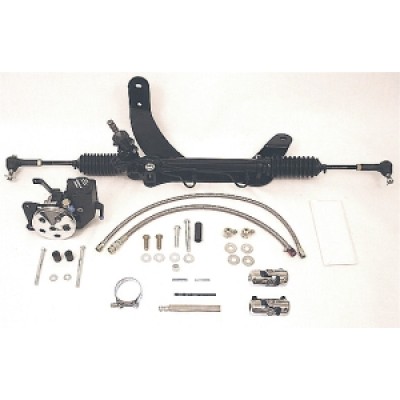

also a Uni-Steer rear steer rack-in-pinion, I bought years ago from Year One,

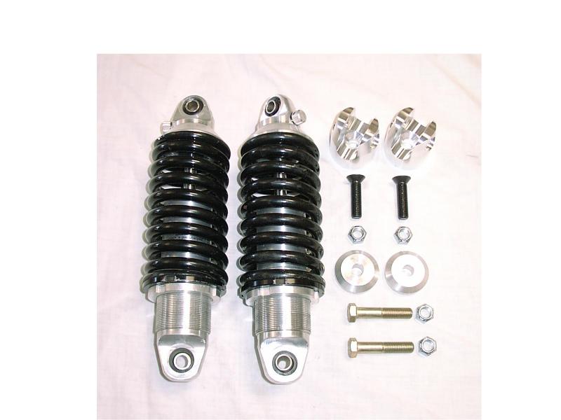

more if you ditch the heavy torsion bars & go to coil-overs, it's like 100#'s off the nose
you have to modify the lower control arm mounts,
because the torsion bar will no longer be in & hold the LCA's forward...

  • Magnumforce Racing  front coil over conversion complete MFR161048-6 $599.jpg

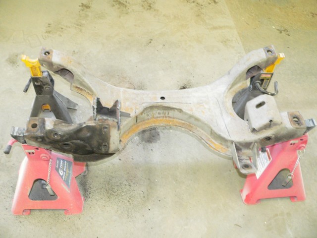

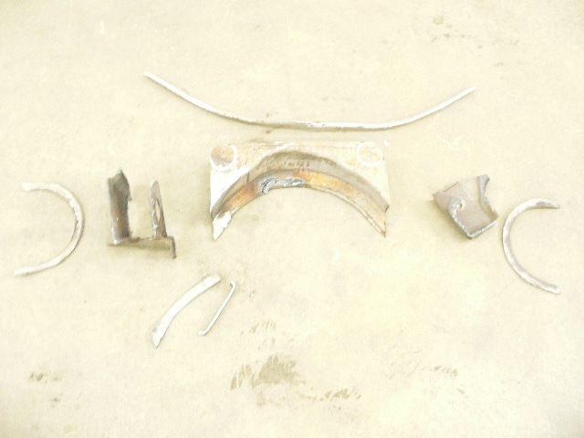

You can a stock one done to less than 30lbs. As I remember mine weighs 20-25lbs now. Cut, weld, bondo,( it's got to look good), paint. Also lost another 10lbs making the strut rods and steering shaft from .750" X.093" moly tubing
Doug
That's too nice!!!!!
