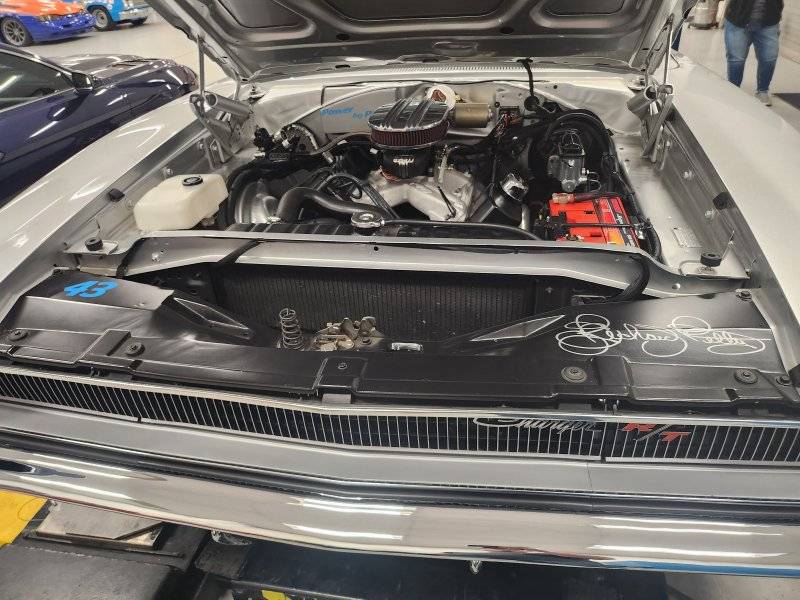

I bought a 68 repro back in 2018, looked good, I would buy another one, it ended up being a little narrower than the original gaps on the side where it hit the inside of the fenders, they were larger than the originals by about a 1/4 to 3/8" on each side, only guy that noticed was an assembly guy that put them in 1968. That was at the Detroit Autorama in 2020 hard to see this is the only pic I have on the computer
one more kinda, this is at Richard Petty's garage earlier this year with its new owner.

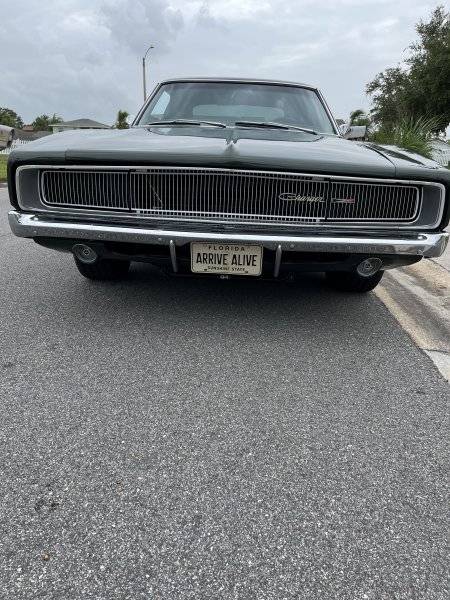

Another 68.
Like the video bought mine from Classic, only place that had it stock last year. I had no issues with the grille.
