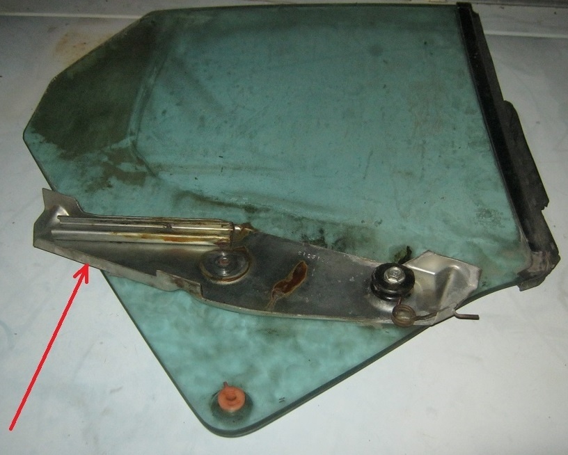

Hello,
Can anyone tell me if quarter window regulators can be adapted for a Roadrunner 1973 with stationary quarter windows?:icon_question::icon_question::icon_question:
By the way I am looking for those metal brackets that holds the quarter glass, if anyone has some spares I am really interested buying them. Mine were oxidized to dust.
Thanks in advance

This pic is for reference only, I've since sold this awhile back. Is this the bracket that you need? If so it's on here for folks to reference to.
:thumbsup:
