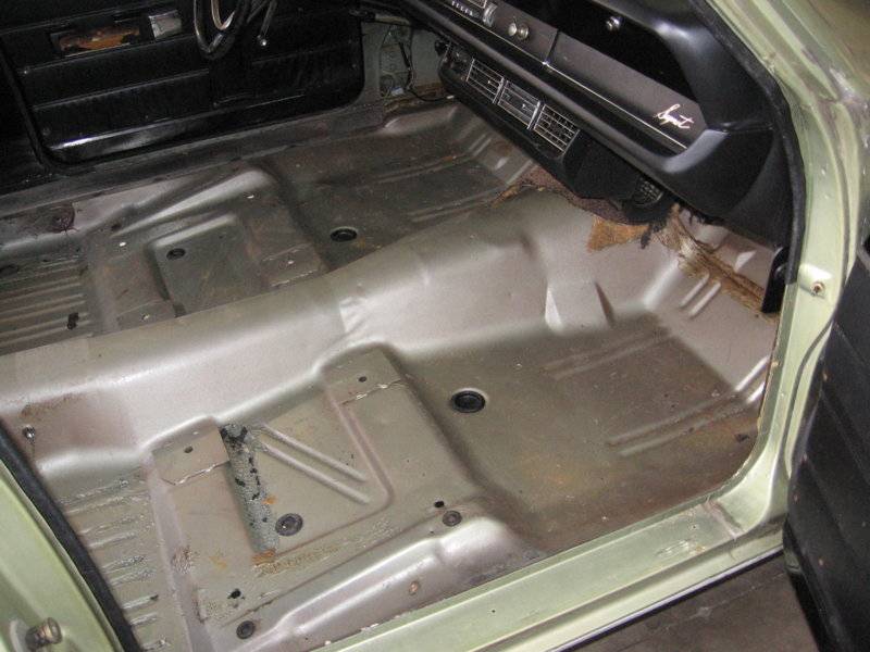

They welded plates to the floor similar to these
Even thought this is a photo of a A-Body,you can see the factory plates welded in. Hope this helps.
darter6 thanks for the pics helps out a lot.
So it done on the inside of the floor pan
Yes ^^ On cars that don't have them, I have put them under the car too.Or at least body washers. Just some piece of mind.
The purpose of the reinforcement plates is to distribute the load of the seat track studs to more than just the relatively thin metal of the floor pan.
