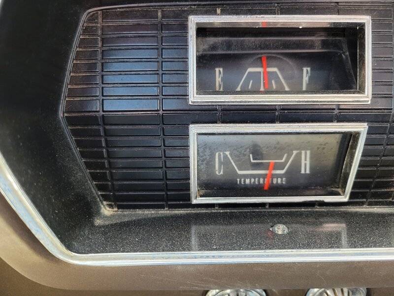

Still having high temp reading sitting in traffic. Wanted to check the gauge so I picked up one of the infrared guns but don't really know the place(s) I need to check. Any suggestions?

Davek: engine is a stock 383, Champion 22" 2 row alum. rad., Ledfoot shroud, 7 blade fan with thermal clutch. Gauge has been reading 230+/- stuck in Georgia traffic but it cools right down to 190+/- on the road. Have checked the water pump at the thermostat and it's 10 degrees cooler than the gauge.

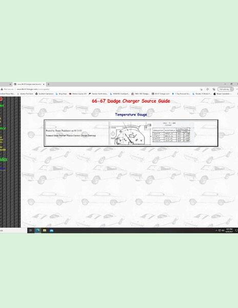

I'm using this image for the temp values on the unmarked lines on the gauge.

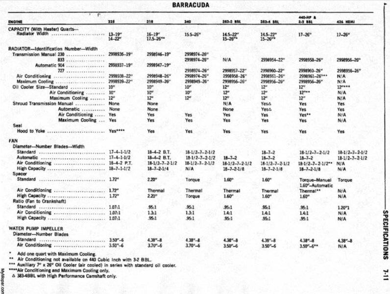

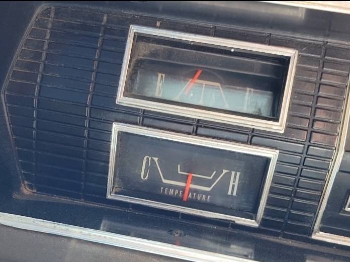

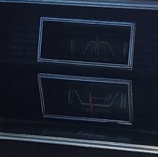

As Cranky said above, larger oval tubes over more tubes. I have a 383/496 in Fort Mohave AZ, 125+ in the summer. 26" radiator, mechanical fan n factory shroud on 2 row aluminum radiator, each row 1.25". 180° t-stat. 174° on interstate, 195° in stop n go w a/c on. 222° sitting parked w a/c on for 10 minutes after a long drive. Here is the non marked gauge readings at 174°, 195° n 222° on my '67 Coronet. As has been mentioned many times here, check your crank and w/p pulley ratios. Also, check temp at the temp sending unit on top of w/p housing. That is where the temp is being takenfrom and where "the engineers" designed the temp to be taken from. Also attached is a pic of specific Mopar stats for cooling systems.
