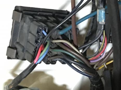

I am going to test the wire with the ohm meter can someone tell me the best way to get the purple wire out of the block on the firewall without damaging the wire ?
The wire is easily removed with a small screwdriver from the front (small tang that holds it in), but once you unplug the block from the bulkhead you can just test the wire from the block itself without removing the wire.
Thanks one more dumb question to remove the bulkhead from the firewall to check the wire do I need to bend those tangs back or does the block slide out ? Once again sorry for the dumb questions wiring is not my strong point
You can test the wire without removing the bulkhead connector from the firewall, just put your probe on the terminal.
And yes if you bend the metal tangs inward the block will push into the cabin.
