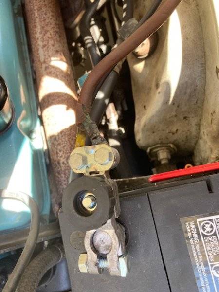

Posting a picture of the brake booster in the 66 I just purchased and don't know if this is the stock unit. As you can see the previous owner went to a dual master cylinder and I believe I will eventually convert the brakes to disc on the front. That might require a different booster???? Also the battery cable has been shortened and also has some noticeable corrosion on the wire. With my earlier MOPARS there is not a NOS replacement for these cables. Anyone have suggestions on how to replace this one or maybe cut the corrosion out and add some length to it?

The best bet for a booster would be a dual-diaphragm one as the power assist with a single one isn't as good as the dual. It appears you have a single one...cr8crshr/Bill:thumbsup::thumbsup::thumbsup: :usflag: :usflag: :usflag:
It looks like the original booster to me. I have the same one on my Plymouth and it seems to work fine with a disc brake conversion.
I imagine it could be more assist than what I have but I like it.
Appreciate the replies. Had not heard of Mega Parts and looks like they have the correct cable but it's wound up and no length indicated so I might have to message them. Sorting this car out I am finding more info on it. Getting to the thermostat last eve was a chore with the A/C compressor in the way and then a frozen bolt. This had not been changed in many-a-years. Probably because of the difficulty of getting to it. But noticed the 383 motor does not have the big block HP data on a pad in front like my 413's. Also found it has a 294 gear tab on the rear end. So I guess it was built for highway use.
I suppose I could try the brake booster in place if it's working well and might just rebuild it if I go to discs. The brakes are not very good (maybe I'm too used to disc) and the PO put Dot 5 fluid in I suppose when the dual master was put on. More to follow.
Stock drum booster with a disc master.
Just put the disc's on and go from there.
The booster you have will work just fine with a disc brake upgrade.
