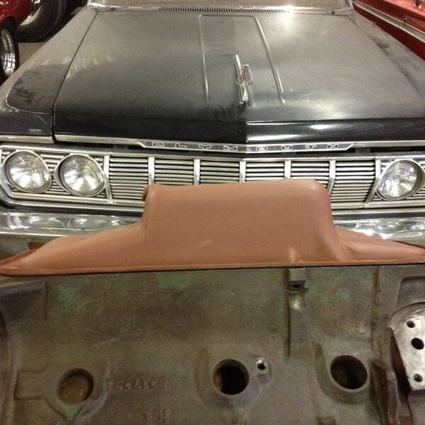

have 1963 polara came with sb going to big block does it take rear sump pan or mid sump?
thank you

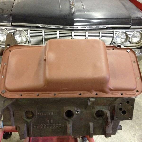

Mid sump for an early B. A little different than later Bs.
My '65 Coronet 426W had a 402 pan when I bought it. I needed to cut the K member in order to deepen the 402 pan by 2".
This is the stock oil pan for the 62-65 B bodies. A few others will fit with careful measuring. Plus the max wedge pan is currently being reproduced.
intresting you dont see much for 63.that 402 pan looks like the one i used good 20 years ago .
some here on the site have one for sale .
