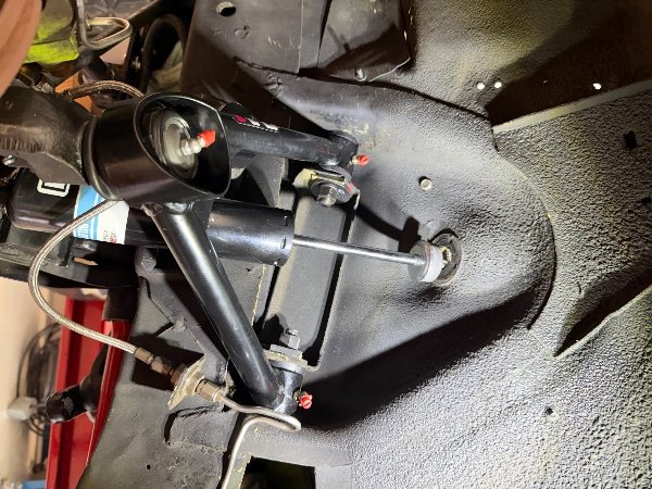

I recently bought bilstein 55-r082 shocks for the front as recommended by others. The problem I'm having is the shocks when installed do not let the upper control arm rest on the bump stops. I would say its off by about atleast 3/4". Removing the shocks, lets it rest on the bump stops. Is this typical? Also, torsion bar is loosened at the moment. Any reason why this would be the case? The cars has been kept stock all it's life.

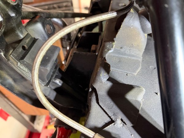

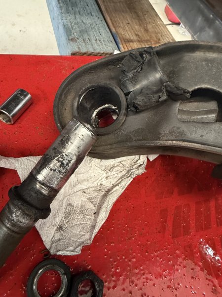

Sounds like the suspension is at full droop from being in the air. To me, normal stuff on the shock. When you let it down, put the bushing/washer/nut on and cinch them down. Did you loosen the bar up? It should still have some load on it even when up in the air. Maybe have dead bars or the lower control arm bushing is toast. Like this one from the 72 Challenger I'm working on.

I loosened the torsion bar to replace the upper control arms. I'll take a closer look at the lower control arms to see if there is excessive wear. Thank you for the replies.

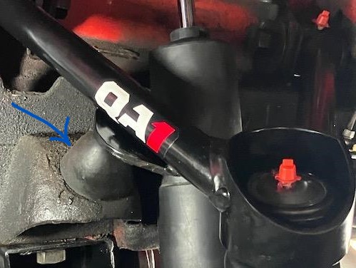

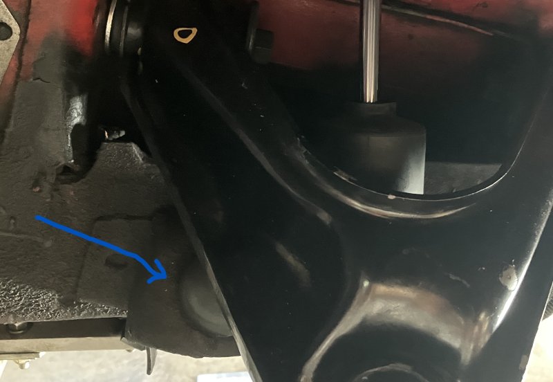

If the car is on jackstands or a car lift, yes...the upper control arms should droop enough to rest on these bumpstops:
If you have tubular UCAs....
If the suspension is at full droop and the upper control arm does not touch the bump stop....yeah, the shocks are too short.
