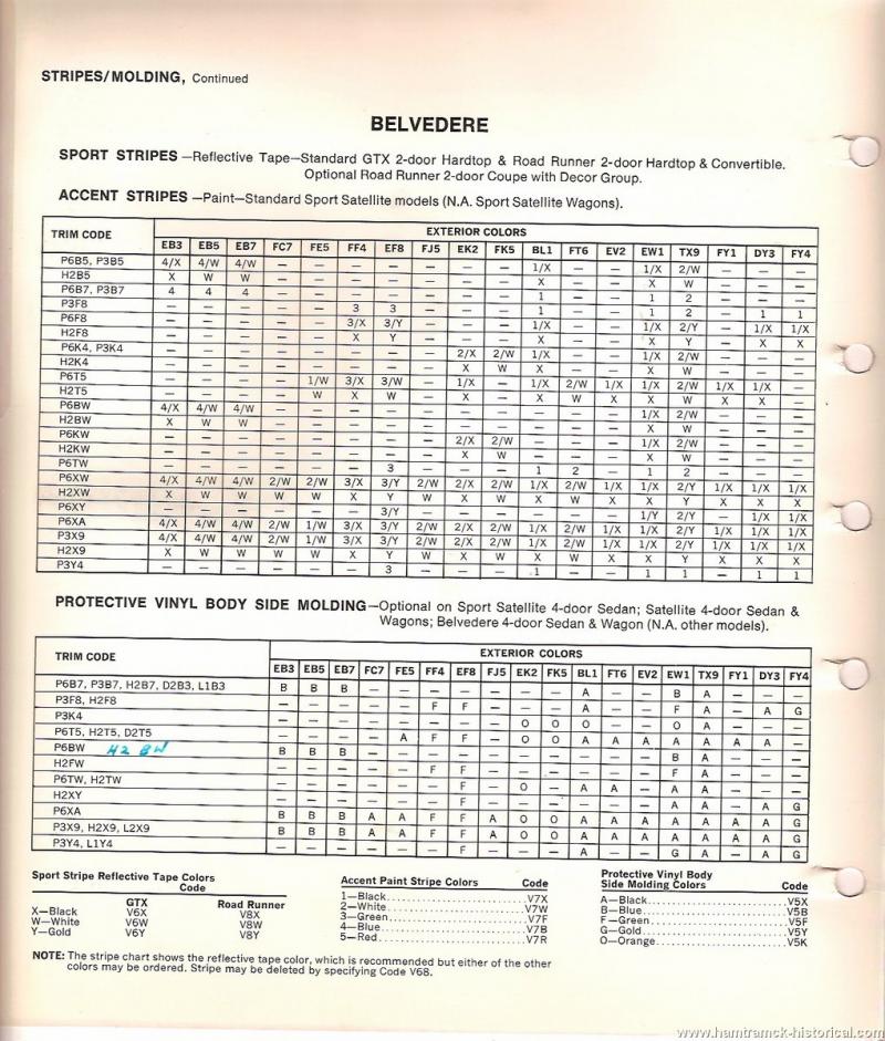

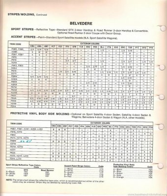

I attached a 1970 color/trim selector & I don't see R6 Scorch Red.....However, if you have 999 for a paint code I believe that is a special order color. I'm guessing that could be any color that Chrysler made that year & "maybe" some other colors too.
