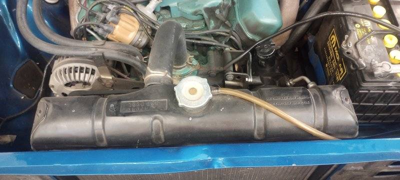

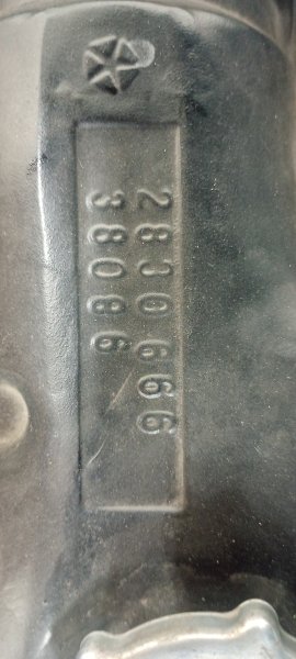

Like the title says, what does the 2830666 radiator come out of? It is currently in my 68 road runner, but I can't find any information on it.
Many of the mopar decoders are for car parts only. my A100 727, radiator and distributor are not showing up in them, so I had a friend look them up as he has many books. They are light truck parts only.

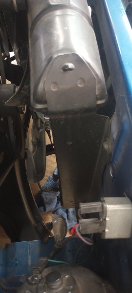

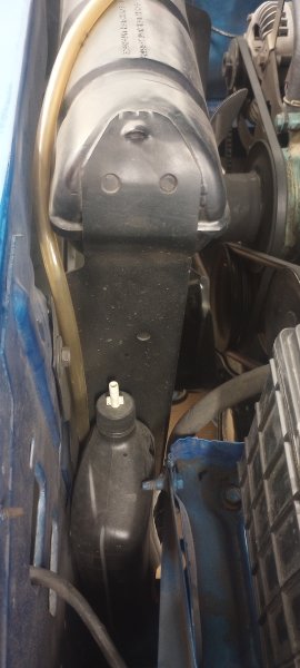

Your Top tank could have been swapped. Show a picture of the mounting brackets. Is the top hose connector 1.5" and bottom hose 1.75"?
Inlet is just on the passenger side of the radiator cap. The side brackets on the radiator look like they are not factory. I don't know what size the connectors are, it's been in the car for 20+ years now.
My 70 GTX had an odd number radiator in it when I got it. It fit just fine but I found out it was from a truck. The car had been wrecked and everything on the front had been replaced. Probably the reason.
