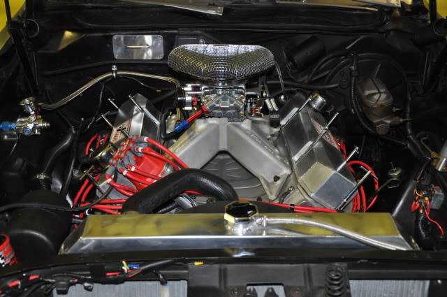

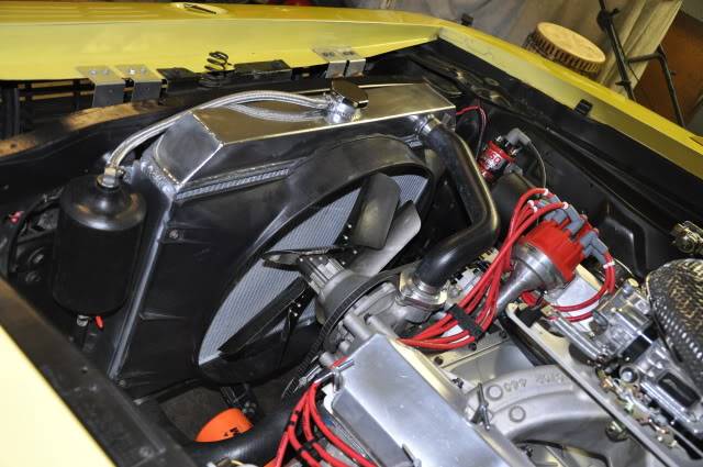

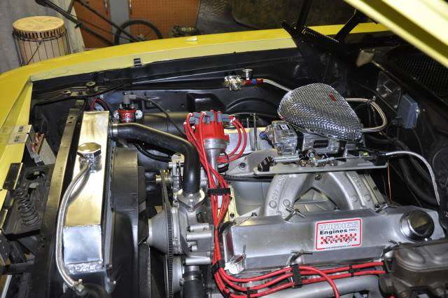

I'm pushing 600hp. I'm not taking any chances with cooling issues. I went with a Ron Davis setup.
