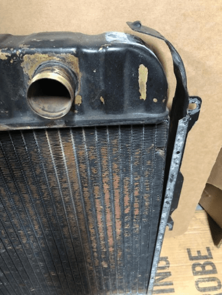

Radiator Mounting Bracket Detached - Need A Quick Fix!
See if you can add some solder to the under side of bracket. then press bracket against tank and heat the bracket pushing it. When solder melts bracket will move against tank. stop heating and hold bracket until solder cools, 1 minute. fixed.

If you are going to epoxy it, you should use 3m 8115 panel bond and cycle it a few times with a heat gun. The fix I outlined earlier is with a torch. Using the solder that is already on the rail and the tank, only heat the top of the rail. It will suck together and when it cools you are done. That’s what the rad shop would do. Or talk you into a 700$ recore. I’ve removed a lot of epoxy from radiators. It will work for the rail but I wouldn’t fix a hose fitting or hole with it

Do what Fran blacker said and move on. This is a simple fix with a Benzomatic propane torch, solder, and flux. If you epoxy it, fixing it right later on will require cleaning all the epoxy off, which will be a PITA. Do it right or do it twice!
