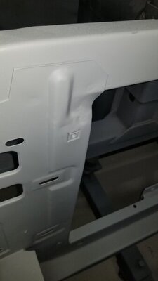

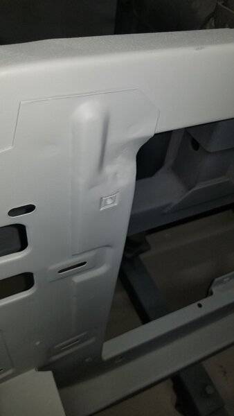

Could you guys take a look at this section on the driver's side radiator support of my 68? I'm not exactly sure what it's supposed to look like but I'm guessing not this. If you have any clear pics that I can send to the body shop that would be awesome, thank you! Matt
A dolly and hammer will fix that in about 5 minutes. Looks like someone made clearance for a crossflow rad cap.

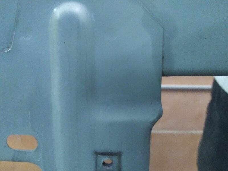

Yeah I just need to show them a pic, was there any stamping in that area of any sort or was it totally flat?
