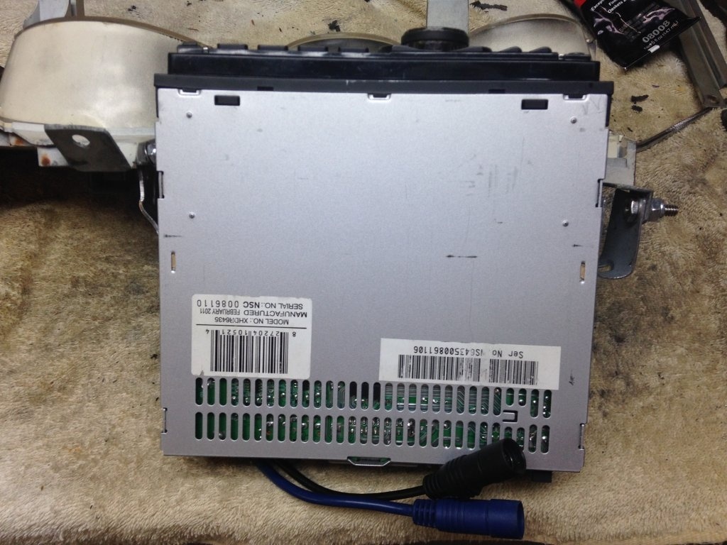

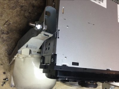

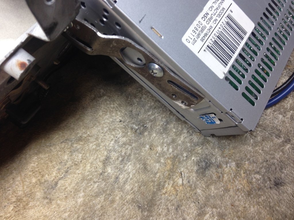

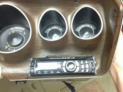

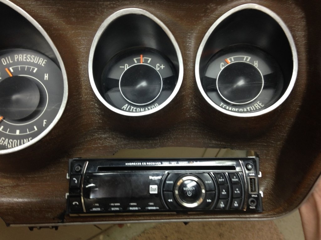

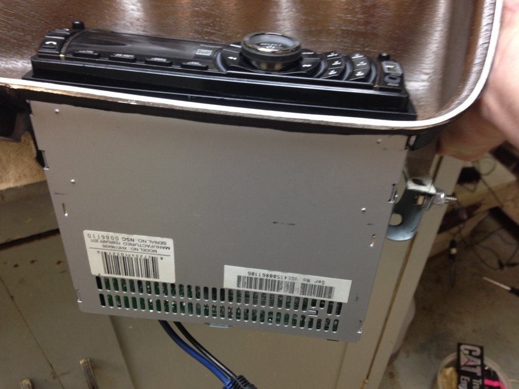

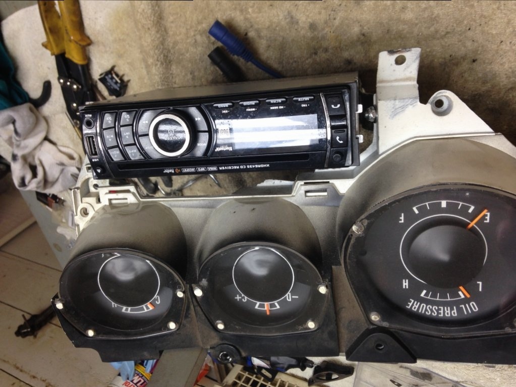

I was in the same boat. used some metal pieces, some screws, and some time for alignment. My setup.
STEREO 7.JPG STEREO 6.JPG STEREO 3.JPG STEREO 5.JPG STEREO 2.JPG STEREO 4.JPG STEREO 1.JPG
That's a curvy looking dash to fill. Does the factory radio fit nicely? - if so there are places that can retro-fit your factory radio to have modern digital components with iPod and other accessories possible.
