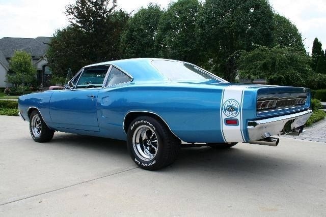

Looking to raise my stance like the pic I have included.Putting on larger wheels and tires than my standard 14 inch. Any suggestions for where to get new leaf springs etc.
295 50-15's 8 inch rim. Inserted a single leaf each side. Summit truck springs modified. Mine was starting to sag with age, luggage, beer coolers.
I did the same thing as Dennis did. Extra half leaf from Summit - called "add a leaf". Only $39 if I remember correctly and raised the rear end 2". Allowed me to fit the L60s on the back.
